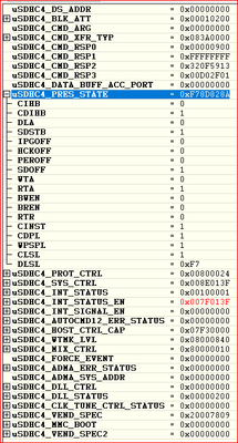

I’m having trouble getting the usdhc controller in the iMX6Q working with  the onboard Micron MTFC4GACAJCN-4M eMMC device. Our driver works fine with SDHC cards (on SDHC2 and SDHC3). SDHC4 is connected to an eMMC device. We realize that some commands are different between SD cards and eMMC devices. The board is an OTS iMX6 Quad from Embedded Artists.
The issue is with sending CMD8 to get the extended CSD – it fails. The following commands are executed successfully before sending the CMD8: CMD0, CMD1, CMD2, CMD3, at this point the operating frequency is changed to 26 MHz per the iMX6 SDK, CMD9, CMD7 (eMMC does go to trans state), CMD6 to change to 8-bit bus, CMD16 ( 512 byte sectors – necessary??), and then CMD8.
On sending CMD8, the command is accepted (INTSTAT bit 0 is a 1), but no data transfers. We’ve tried the SDK code (PIO mode to double check) and our own code which uses DMA, but no data transfers. Here are the registers (SDK PIO mode) while waiting for data to transfer:
Note that INTSTAT is 1 (command complete), but PRSSTAT bit BREN is low meaning no data is available to read. CDIHB is high indicating transfer in progress. RTA is high indicating a data read is active. BLK_ATT shows 1 block of 512 bytes. Should SDOFF be high at this point or does that matter?

Reading stalls waiting for the SDHC_PRSSTAT_BREN bit to be set – which never happens. This is using the SDK code.
Any ideas?
6,382 Views
ogj
My bad - didn't read the TRM closely. When setting up the IOMUXC for the data pins I thought the pin muxes for port SDHC4 would be ALT_FUNC_0 like the other SDHC ports. Turns out they should be ALT_FUNC_1. Thanks for your help. Everything works now.
