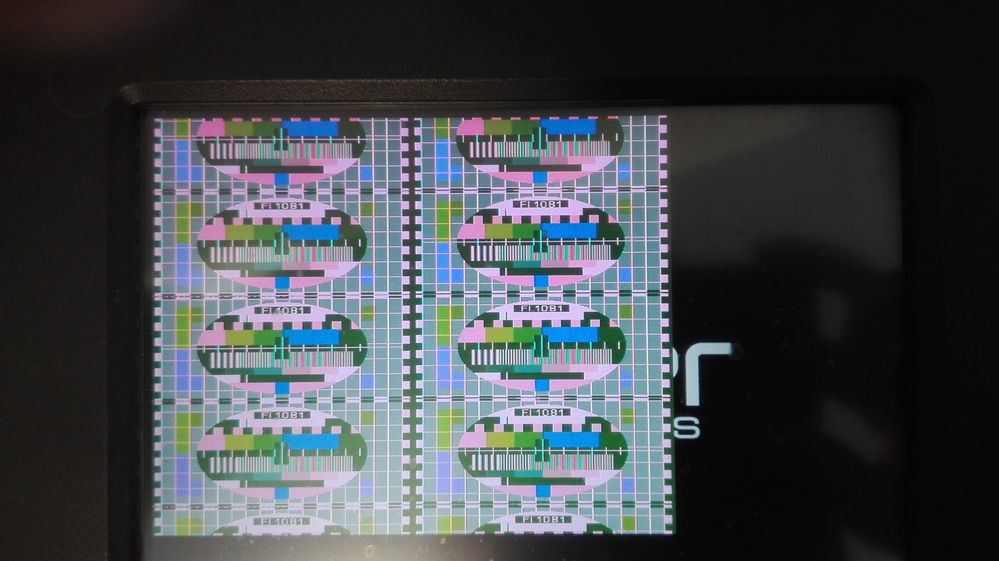

We success in display first acquisition from adv7282-m device after a problematic start (see https://community.nxp.com/message/830163 message)
We use PAL video signal and we test without adv7282 progressive format, and with progressive format (mipi clock is double). In these two adv7282 configuration case, we don't reach to synchronize output display image acquisition.
The ADV7282-M output data is 8-bit YCrCb 4:2:2 format and it uses one lane.
Routing MIPI stream into CSI2 is Ok.
But gstreamer command :
gst-launch-1.0 --gst-debug=*:1 -v imxv4l2src device=/dev/video0 ! imxv4l2sink
displays:
 Colors are wrong and there is also a vertical scrolling (see mp4 file).

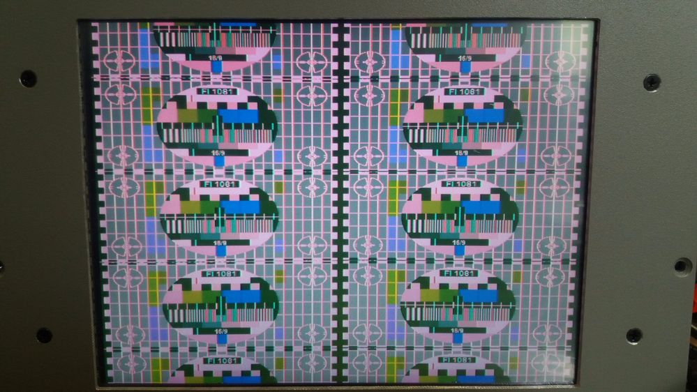

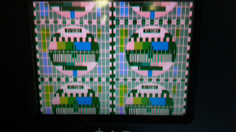

Thanks for your fedback. We try to apply adviced pathes but it don't fix IPU management problem we have.
In fact there is a problem if we use patch from drivers/mxc/ipu3/ipu_capture.c because _ipu_smfc_init force mipi source to 0 (instead of 1 in our case) and changes in _ipu_csi_set_mipi_di function generates no diplay, "VIDIOC_DQBUF failed." error message and timeout (see time-out trace in following LOG).
For the moment, it is not a routing problem with the mipi virtual channel #1. The routing seem ok but in the display we get 4 images from mipi source and a wrong YUV decoding (color are not good).
We try to use linux4 kernel (4.1.29 with sabresd target) from krogoth yocto source.
The only way we examine is mxc_v4l2_capture.c file is not as advanced as file there is in 3.14.52 (yocto-jethro).
We still search why there is a IPU configuration problem to display the mipi flow.
If we set ADV7282-M in free-run pattern to color bars, we also get 4 images in the display. So we think it is not depending on analog harware decoder.
How it is possible to configure IPU format & decoding to adjust mipi flow configuration ?

We continue to work to solve this problem. We use 'MIPI-CSI2 Perepherical on i.MX6 MPUs, Application Note, Rev. 0, 07/2016 document to check iMX6 registers configurations' document to make checks.
We use adv7282m in progressive mode.
We still have an acquisition format and synchronization problem in with mipi video flow.
See latest result. We get 8 images (instead of 1) and scrolling down problem.
We use freescale capture tool :
       /unit_tests/mxc_v4l2_tvin.out  -ow 1024 -oh 768 -ol 0 -ot 0
We think there is a special ipu configuration to do. The OV5640 example camera use two lanes (adv7282m uses only one lane).
Extra mipi or ipu synchronization informations to help us will be welcome.
G.Grange
18,313 Views
qiang_li-mpu_se
From your dumpped IDMAC setting, the data format and bpp setting is wrong, for adv7282m, the input video data should be 16bpp UYVY format.
[   26.209968] imx-ipuv3 2400000.ipu: ch 1 word 0 - 00000000 32A00000 00000000 E0020000 0008FC59
[   26.209982] imx-ipuv3 2400000.ipu: ch 1 word 1 - 0D700000 69AE0000 0087C001 000167C0 000002CF

Our picture always scrolling but something news, we have 8 pictures (4 pictures with old parameters):
What others parameters I have to verify ?

The patch is active ("cfg_param.clk_mode = IPU_CSI_CLK_MODE_GATED_CLK;" on ipu_capture.c)
I note that the EXT_VSYNC bit is activated.
What do you think about results?
18,305 Views
dtamarii
same result on  our display (8 pictures scrolling)
18,299 Views
qiang_li-mpu_se
The reference patch "0001-Correct-mipi-camera-virtual-channel-setting-in-ipu_c.patch" in "Sample code for iMX6 SabreSD to use MIPI CSI camera with virtual channel 3 " is must since you are not using virtual channel 0. You can reference to that patch to set virtual channel 1 or 3 use case.
The default BSP has issue for not 0 virtual channel setting.
"0x02638020: FFFF1EFF " this register is wrong, and IPU_SMFC_MAP register will also be wrong without that patch.
