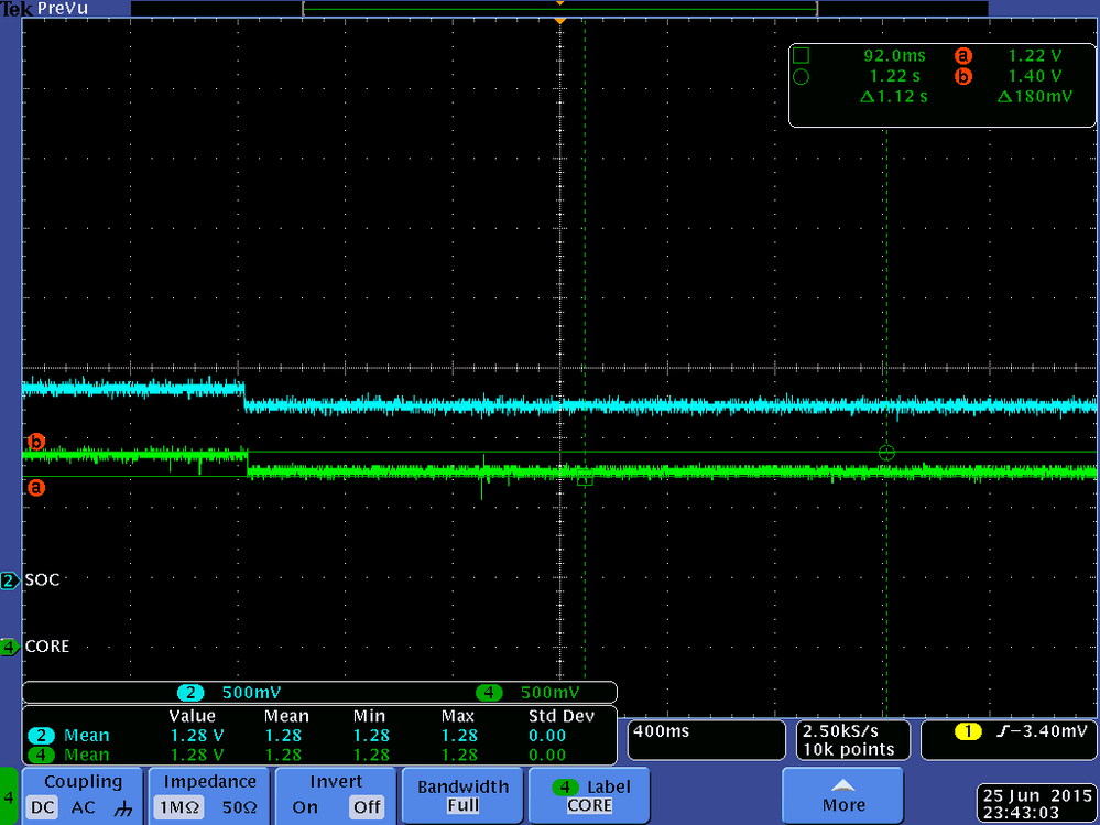

In Imx6 Quad , after pressing RESET switch SOM doesn't boot again. it boots only after hard power on/off.
As per my understanding, through external reset released, internal Reset will release only after  VDD_ARM_CAP and VDD_SOC_CAP supplies
are stable (internal  LDO_CORE and LDO_SOC).
so , i doubt these internal voltage domains and their input voltages  VCC_SW1AB_CORE and VCC_SW1C_SOC of PMIC (MMPF0100F0AEP)
Findings:
1. in Linux, boots  after reset  switch is pressed with out problem and  VCC_SW1AB_CORE and VCC_SW1C_SOC voltages of  PMIC are fine. ( no voltage dip occurs-here current consumption from  VCC_SW1AB_CORE is  < 500mA)
2. In android
         1. if reset switch is pressed at the time of uboot, and kernel loading , booting occurs without problem ( up to this process current consumption form VCC_SW1AB_CORE is  < 700mA )
         2. once android application launches , current consumption from VCC_SW1AB_CORE is increased >900mA, and voltages dip occurs ( snap shot attached) if reset switch is pressed now,  doesn't boot again.
3. first dip occurs from 1.35 to 1.28V at that time current is around 700mA.  if i press reset switch here, boot occurs without problem
4. After some time (  launching android application) continuous dip occurs  from ( 1.28V to 0.992V) here current is around 900mA  . if i reset here, board doesn't boot . and
VCC_SW1AB_CORE is in 0.992V itself.
Green -VCC_SW1AB_CORE of PMIC
Blue-
Same issues occurs in 3 boards.
Is anyone faced this issue...? Pls let me know the solution for this.?
Tamilarasan.

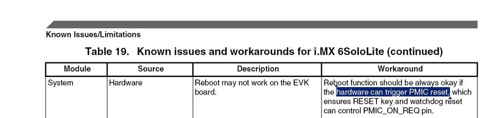

HI Tamilarasan
recommended to use such reset circuit , which resets both PMIC and
i.MX6, because for example, if i.MX6 in ldo-bypas mode, resetting only
processor will hang it (PMIC voltages may be insufficient for successful boot).
This is addressed by Sabre SD reset circuit design (WDOG connection to PWRON)
i.MX6_SABRE_SDP_DESIGNFILES  spf-27392 p.21 and description in Release Notes

yes your are correct, this issues occurs only at the time of LDO By pass mode..
can you pls share the errata and workarounds for imx6..? where i will get..?
Tamilarasan
2,957 Views
igorpadykov
HI Tamilarasan
this is not erratum, this is expected behaviour,
workaround is given in my previous answer.
~igor
