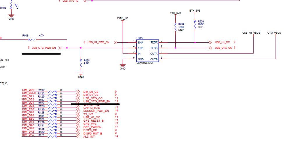

We are using a spinoff of a Boundary Nitrogen6x, kernel 3.0.35. When I plug a mouse on the OTG it is detected and work fine.
However we changed the uboot (was 2013.10, now 2014.04) to have support for signed kernel and now when I plug a mouse on OTG I have this message in kernel:
wait otg vbus change timeout!
and it does not work. We have not changed the kernel, so it looks like the previous uboot configured something about OTG that we are missing.
I put this in my new uboot:
       imx_iomux_v3_setup_pad(MX6_PAD_ENET_RX_ER__USB_OTG_ID);
       imx_iomux_v3_setup_pad(MX6_PAD_EIM_D22__GPIO3_IO22);
       /* USB_OTG_PWR = 0 */
       gpio_direction_output(USB_OTG_PWR, 0);
But it is still not working in kernel.
Any clues? If I have no support for USB-OTG in uboot, what is missing in the kernel to configure it? I see in my dmesg that the module is loaded

I somehow missed this in our new uboot:
NEW_PAD_CTRL(MX6_PAD_EIM_D22__GPIO3_IO22, OUTPUT_40OHM),
Now it is working, but instead of modifying uboot I will try to put the pad settings in kernel where they should belongs to make OTG working

BiyongSUN
The otg power switch is handled by SOC internal, which is using the USB_OTG_PWR_EN and determined by otg id.
The GPIO could not guarantee the timing.
The hardware design could refer to the i.MX6Q SDB board reference design.
1,674 次查看
frédéric
We wil double-check the schematic, but as I wrote, it works fine with Nitrogen6x uboot 2013.10, but not with 2014.04, so something is initialized differently.
