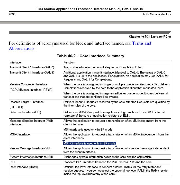

igorpadykov
Hi concerned12345
according to i.MX6SX Reference Manual it is supported only in EP mode.
igor
2,293 Views
concerned12345
Hi Igor,
In the line above the one you've highlighted it states:
MSI interface is used only in EP mode
I have gotten single MSI to work by calling pci_enable_msi() while the iMX6 is acting as a root complex. If the iMX6 can receive MSI messages from an EP device as RC it should be able to receive MSI-X and multi MSI. I noticed that document is for the solo and I'm running the quad although I doubt there is much difference in this department.

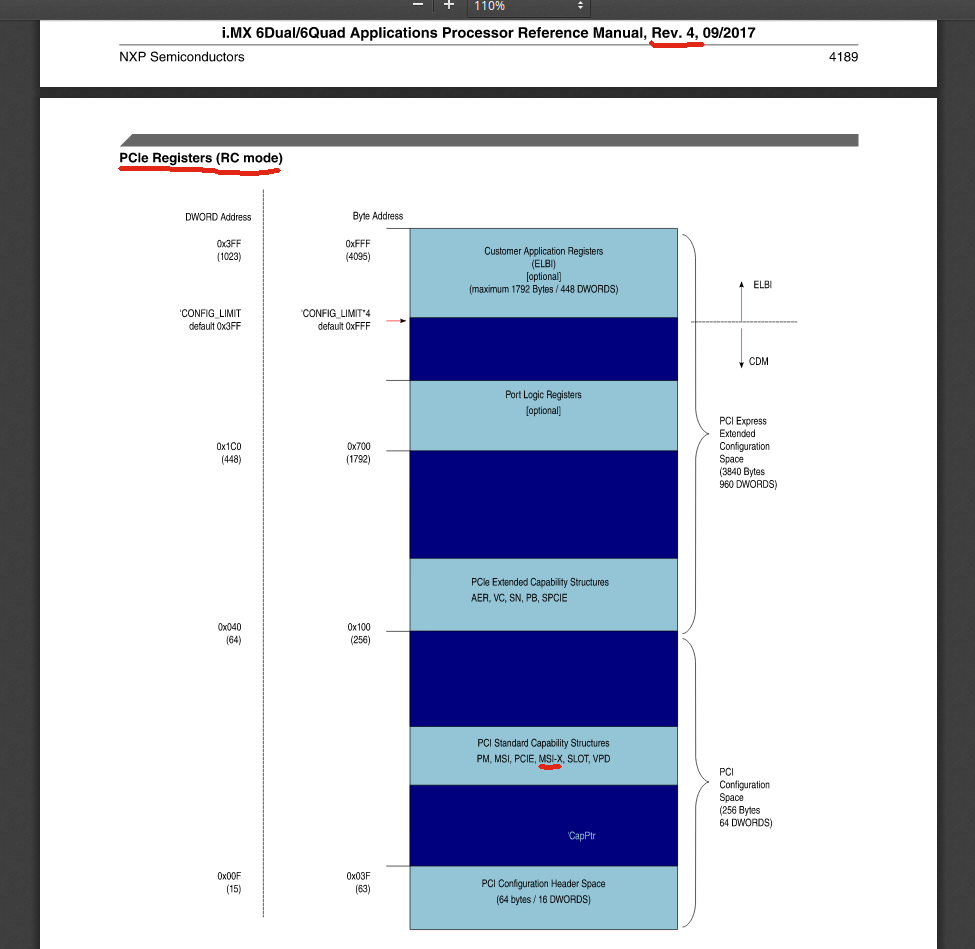

When looking at revision 4 (p 4190) of the same document I found MSI-X in RC for the iMX6Q:

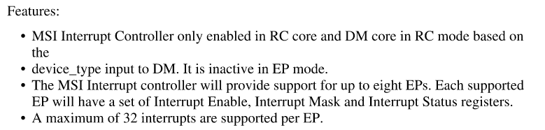

I also found the following on page 4117 of the rev. 4 document which states the iMX6 in RC mode can support/receive 32 interrupts per EP:

igorpadykov
Hi concerned12345
Table 48-2 rev.4 states the same, i.MX6Solo PCIe is the same as i.MX6Q.
page 4117 gives generic IP memory map, particular i.MX6 implementation may lack some features,
as stated on Table 48-2.

concerned12345
Hi Igor,
When looking at table 48-2 of rev. 4 on page 4053 I see it also says:
In my previous post I stated that I am able to get MSI working when in RC mode so that above statement is false. Was table 48-2 of rev. 4 copied over from table 46-2 of rev. 1 without taking into account updates? I know there have been fixes to the PCIe driver code since kernel v3 for the iMX6.
I don't want this thread to turn into us quoting the spec sheet, is there a way to contact an engineer and ask if MSI-X and multi MSI (non -X) is supported an if so has it been tested with real hardware?
