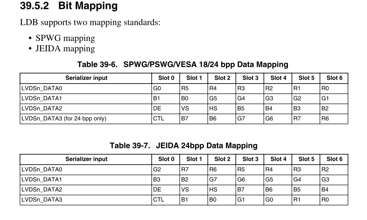

I am not clear about the 24 bit SPWG/PSWG/VESA  data mapping given in imx6 technical reference manual section 39.5.2. In below table 39.6, R6,G6,B6 represents LSB color bit  or 6th color bits ?  ( when BIT_MAPPING_CH0 = 0 ,SPWG and DATA_WIDTH_CH0=1, 24 bit)

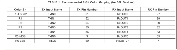

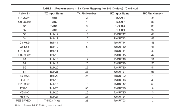

I am trying to interface 2 different 24 bit parallel RGB display with imx6 using LVDS0 port with Ti's deserilizer chip, DS90CF384A.  In the below figure (table 1) R6 is LSB , R7 is LSB +1 , R0 is LSB+2 ,... and R5 is MSB and it is similar for Green and Blue data.
By comparing  deserializer chip mapping and imx6 bit mapping,  the data coming out of imx6 at  LVDSn_DATA3 lane   ( B6 B7 G6 G7 R6 R7 ) should be LSB in 24 bit map. is this correct?
If i considered the data coming out of imx6 at  LVDSn_DATA3 lane (B6 B7 G6 G7 R6 R7 ) as MSB bits, one  display is working properly and another 24 bit display doesn't work in this mapping ( corrupted colors)
if I considered those data as LSB as per deserilizer chip both displays images are not proper. can anyone confirm iMX6 side data mapping properly for 18 bit mode and 24 bit mode? Particularly for LVDSn_DATA3 lane.

Please refer to attached OpenLDI Specification document and compare the data mapping, given on the Figure 5-3 of this document, with the i.MX6 24-bit LVDS data mapping, given in the Table 39-6 of the i.MX6Dual/Quad Reference Manual document. As it can be seen, the answer is: yes, the LVDS data mapping is denoted correctly for the i.MX6 processors, and B6, B7, G6, G7, R6, R7 mean the MSB color bits.
