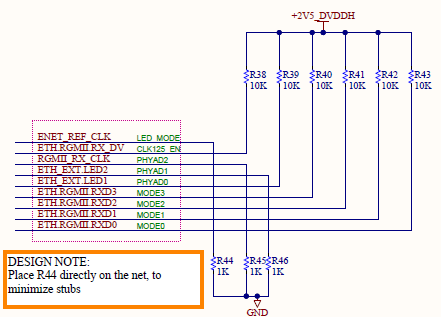

Hi there, we are using a board with an iMX6QP and a KSZ9031.
When we power the board we have 1GBps connection without a problem in both uboot and kernel.
The problem is that after a reboot, we cannot get ip address from dhcp in uboot.
If we boot from Nand, kernel can fix the mac/phy/dhcp issue.
Any ideas about what is happening? Thanks in advance for your help!
The u-boot log error is:

The uboot code is:

static int reset_enet_phy()
/* Reset KSZ9031 PHY */
gpio_request(GPIO_ETH_RESET, "GPIO_ETH_RESET");
gpio_direction_output(GPIO_ETH_RESET, 0);
mdelay(10);
gpio_set_value(GPIO_ETH_RESET, 1);
mdelay(100);
gpio_free(GPIO_ETH_RESET);
return 0;

igorpadykov
Hi joan
one can check if KSZ9031 was correctly reset and its power-up sequence
according to its datasheet. In general such issues may happen when reboot
performing without full board reset as it is done in NXP i.MX6QP Sabre SD
reference board (p.21 U507, with WDOG_B and PWRON SPF-28857.pdf schematic)
Design files, including hardware schematics, Gerbers, and OrCAD files for i.MX 6QuadPlus (i.MX 6Dual...
igor
