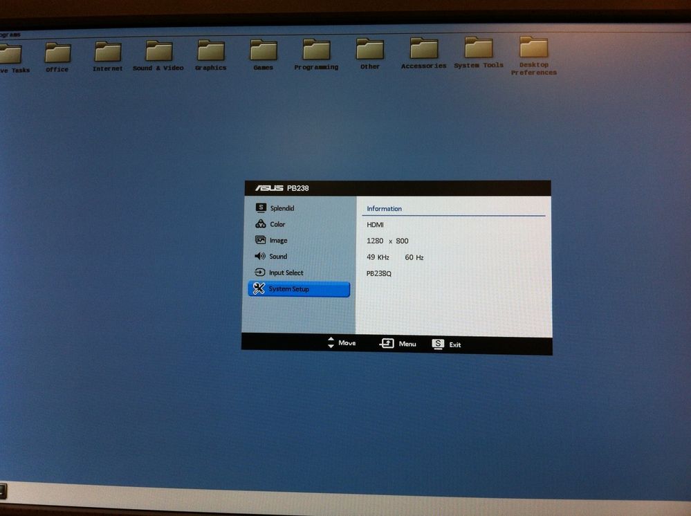

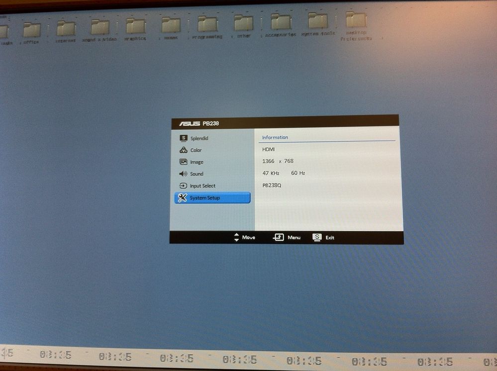

williamtung
Hi Michael,
I can forced it out put 1366x768 with your suggestion, but Xiaoli's table didn't work correctly. The best result I could get so far is the table below. I confirmed this monitor can accept 1366x768 resolution from my laptop HDMI output. Just for comparison, I can manually set 1280x800 and 1280x720 resolutions and get correct display on the same monitor. Can you share the videomode information? Thanks.
static const struct fb_videomode wxga_mode = {
  /* 15 1366x768-60 VESA */
  NULL, 60, 1366, 768, 13806, 120, 10, 14, 3, 32, 5, 0,
  FB_VMODE_NONINTERLACED, 0
root@freescale ~$ cat /sys/class/graphics/fb0/modes
S:1920x1080p-60
S:1920x1080p-50
S:1280x720p-60
S:1280x720p-50
S:720x576p-50
S:720x576p-50
S:720x480p-60
S:720x480p-60
S:640x480p-60
V:640x480p-60
D:1920x1080p-60
D:1366x768p-60
U:640x480p-60
D:1366x768p-60
S:1920x1080p-60
S:1920x1080p-50
S:1280x720p-60
S:1280x720p-50
S:720x576p-50
S:720x576p-50
S:720x480p-60
S:720x480p-60
S:640x480p-60
V:640x480p-60
D:1920x1080p-60
U:1280x800p-60
V:1280x1024p-60
U:640x480p-60
U:1280x800p-60
