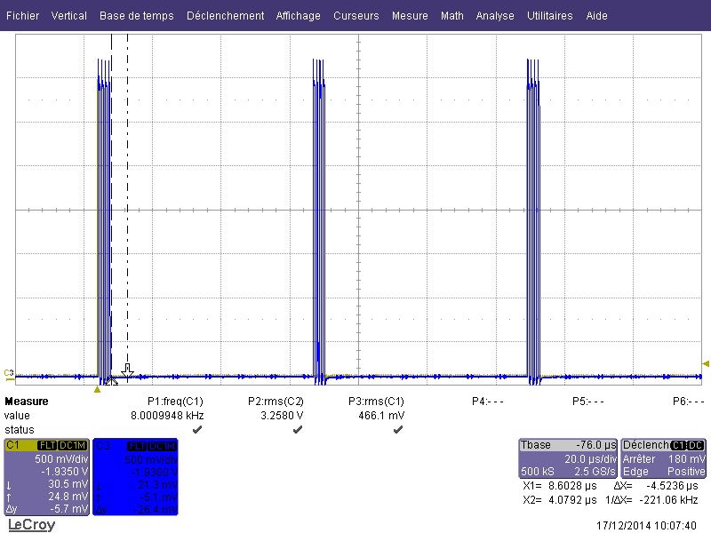

When underrun occured (when I see that with an oscilloscope)
There is no interrupt generated ...

ZeeFrench
Bonjour Aurélien,
Your problem seems to have multiple aspects, setting dma was one of it and the oscilloscope above looks like a channel swapping issue (in case of overrun) that is supposed to be fixed by an other group of patches in Yocto http://git.freescale.com/git/cgit.cgi/imx/linux-2.6-imx.git/log/sound/soc/fsl/fsl_esai.c?h=imx_3.10.... (apparently not in the mainline kernel). This is becoming difficult to follow (do you still have swapping now you are back on beta2 ?), especially if you add a new issue below that is not your use case (looking at our alsa driver documentation, 22 kHz is a standard frequency but no trace of 20 kHz).
I think we need to dig the root cause of underun (and / or overrun ?), not necessary in the esai driver but maybe in dma, since you open a new thread, i propose to follow on that one if that ofk with you ?

I don't understand 20KHz trace ?
I am using 64 slots of 8 bits word at 8000Hz => mclk=2048000Hz
Thank you for your interest in my problem, I really appreciate it
Aurelien BOUIN

aurelienbouin
So I am using the ESAI with the master branch of the main git git://git.kernel.org/pub/scm/linux/kernel/git/stable/linux-stable.git
And I can see that my channels are randomly switching ... seems like the ESAI chip errata is here ...
On the fallowing pictures you can see in blue datas, in yellow frame synchro
You can see on the first attached picture the initial situation : channel[0] et channel[16] have 0xAA, and others 0x0
And after sometimes we get that :
I don't see any debug message concerning xrun or underrrun ...
