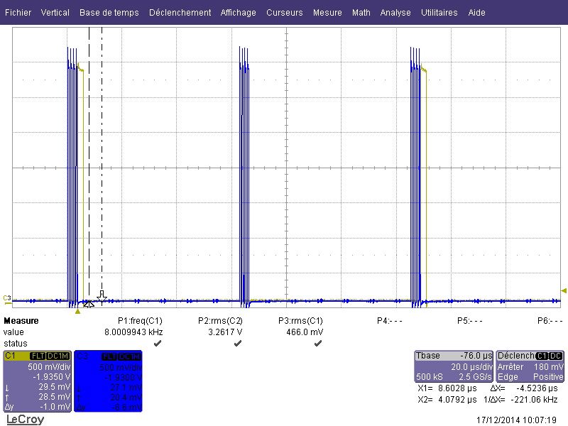

So I am using the ESAI with the master branch of the main git git://git.kernel.org/pub/scm/linux/kernel/git/stable/linux-stable.git
And I can see that my channels are randomly switching ... seems like the ESAI chip errata is here ...
On the fallowing pictures you can see in blue datas, in yellow frame synchro
You can see on the first attached picture the initial situation : channel[0] et channel[16] have 0xAA, and others 0x0
And after sometimes we get that :
I don't see any debug message concerning xrun or underrrun ...
Thank you for your help,
Aurelien BOUIN
