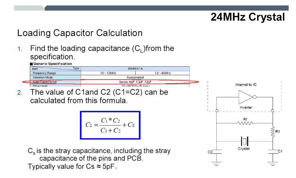

igorpadykov
Hi Jim
one can check both 32.768KHz and 24MHz crystals requirements
given by MX53UG Chapter 1 Design Checklist, and test signals
by oscilloscope. Try to prolong POR up to 1 sec. and check if this
helps. Also reason may be in low quality crystal or parasitic
resistance on board traces, so crystal can not start. For
load caps one can look at below picture (note this is applicable
to both 32.768KHz and 24MHz crystals)
igor

jahlman
Thanks for the reply Igor. Unfortunately I misstated my problem slightly. The crystal does start, but the iMX does not start the boot process, or starts very slowly without touching the part with my finger. My initial assumption was that the stray capacitance was ~5pF, so I set the two load caps at 10pF each. I'm using a CTS425 series crystal at 24 MHz and 80 ohms ESR. Once started the crystal operates at 24MHz. As I stated in the original message I also tried two 18pF caps (assuming stray C was ~1pF), but this didn't help. I apologize for the confusion.
The first revision of the board seemed to work, so I fixed the errors and moved on.
Right now I have three boards with the new PCB that have problems:
One will boot on its own, but it is really slow during the U-Boot phase unless I touch the part with my finger. After U-Boot ends it seems to load Linux and operate normally.
Two will not start the boot process without touching the part. After that they seem to boot normally.
It seems that there's something that's not happy with the internal clock or PLLs that's keeping the part from operating normally.
I based my design off the Freescale Quick Start board, and followed the user guide closely (I thought anyway).
