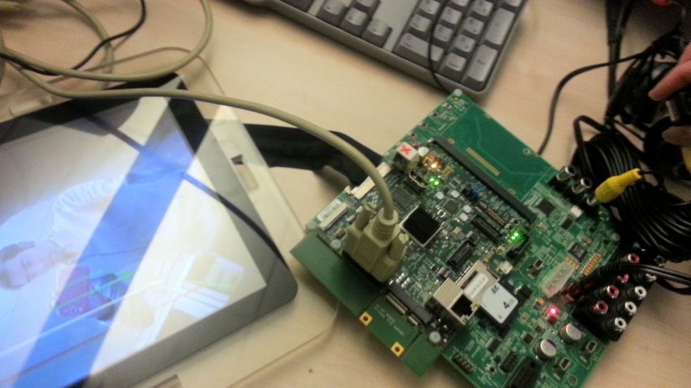

It´s for iMX53 ARD (SABRE AI)
modprobe ipu_prp_enc.ko
modprobe ipu_prp_vf_sdc.ko
modprobe ipu_prp_vf_sdc_bg.ko
modprobe ipu_still.ko
modprobe ipu_csi_enc.ko
modprobe adv7180_tvin.ko
modprobe mxc_v4l2_capture.ko
root@freescale ~$ lsmod
Module Size Used by
mxc_v4l2_capture 18316 1
adv7180_tvin 4361 0
ipu_csi_enc 2445 1 mxc_v4l2_capture
ipu_still 1667 1 mxc_v4l2_capture
ipu_prp_vf_sdc_bg 3273 1 mxc_v4l2_capture
ipu_prp_vf_sdc 3364 1 mxc_v4l2_capture
ipu_prp_enc 3841 1 mxc_v4l2_capture

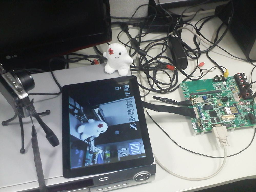

/unit_tests/mxc_v4l2_tvin.out -ow 1024 -oh 768 -ol 10 -ot 20 -f YU12
I tested using BSP11.05 running on ARD (iMX53)
I connected composite cable on J42
Please, take a look on video I made for Demo:
http://imxcommunity.org/video/tv-in-on-ard
