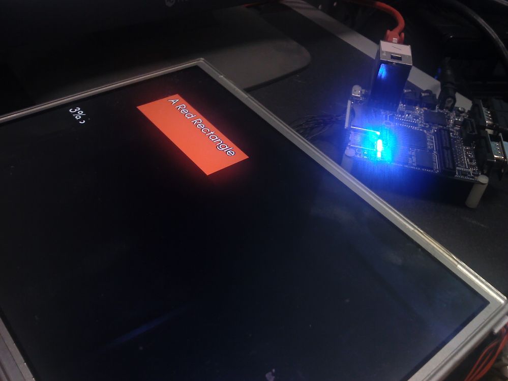

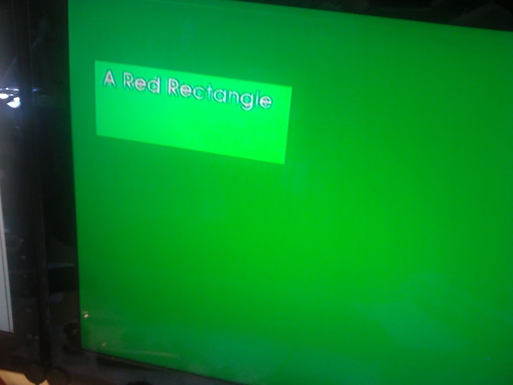

Hi All,
I am working on the iMX53 QSB running uBoot and Linux and I tried to have a LVDS screen (fb0 primary) and a CVBS (fb1) output working at the same time.
The LVDS is fine and display exactly what I want but the CVBS output doesn't work properly:
- I get some video on my connected screen in PAL or NTSC format but the colours are wrong.
- As soon as I unblank fb1 my display detect the video and I get a screen with a dark green background
- Then it does display my test images but the colours don't match (see pics)
CVBS
LVDS
The screen is connected on the VGA connector - pin 2, and here are the modifications I have done:
- in mx53_loco.c: ".boot_enable = MXC_TVE_TVOUT;"
- in uboot: "video=mxcdi1fb:RGB24,TV-PAL tve=di1"
Has anybody encountered this issue?
Have I missed something?

mlinuxl
Hi Xavier,
I  think, actually i am sure that you need SCS (colorspace conversion).
LVDS Display use RGB colorspace but TVE in CVBS mode expect YUV colorspace.
This is reason why your background is green..:)
I also had same situation some months ago.
When you use single display your interface is set to YUV colorspace and you have right colors on CVBS TV video out.
I managed to get different colorspace simultaneously for Display Interface 0 DI0->RGB (parallel display in my case) and Display Interface 1 DI1->YUV (tve cvbs in my case) with the Display Processor DP (page 2743 in the datasheet).
I can help you if you use newer kernel version (3.12 and above) but i think that you use LTIB 2.6.35 kernel..? I have checked source in tve.c for your kernel and it is right set for CVBS not YPbPr. It seems that is set for YPbPr but it is actually not. It is set for CVBS, look better..
According to this:
You can use TVE only as DI1 secondary display not as primary..
Next, when you use TVE encoder in VGA mode it expect GBR24 format, so you have same colorspace for LVDS and VGA.. This is reason why VGA work right with LVDS..
I have problem with synchronization in my kernel version, so i'm still working on that..:(
Maybe there are some who can help me. I opened new thread for my problem:
CVBS TV encoder on i.MX53
6,153 Views
