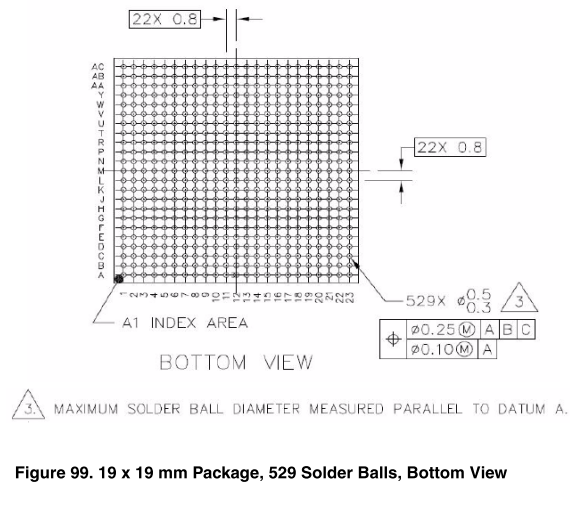

We design our custom board based on MCIMX53-START-R.
I want to make the symbol of TEPBGA529 with Altium. But recommended PAD size is not found.
TEPBGA529 has 12mil PAD & 16mil Soldermask on MCIMX53-START-R. But I think that it is low reliability.
When I design BGA of 0.8mm, I always use the 14mil PAD and 18mil Soldermask.
I think that 16mil(0.4mm) pad is highest reliability, because solder balls of TEPBGA529 is 11.8mil(0.3mm) ~ 19.7mil(0.5mm).
how do you think?

I overlooked it. I can do a design in peace.
1,385 Views
ronak123
Go through MX53UG.pdf,
Section 2.1 Basic Design Recommendations might be helpful.
