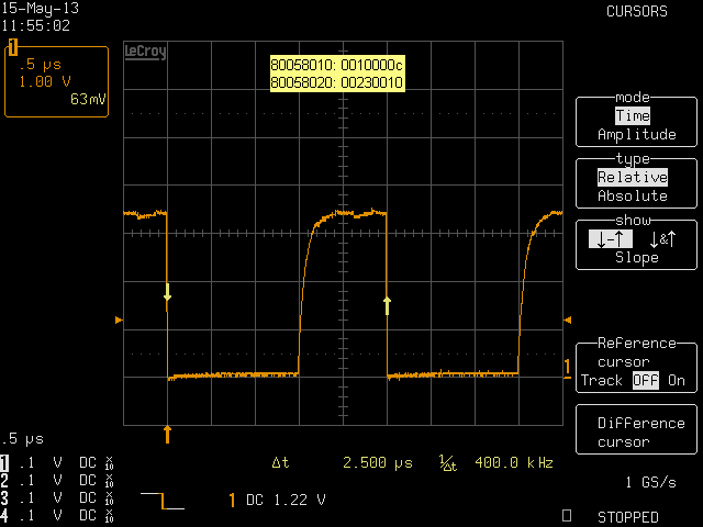

I've just been scoping the I2C clock line on my board and have noticed the following.
If HW_I2C_TIMING0 and HW_I2C_TIMING1 are set to 0x000f0007 and 0x001f000f for 400kHz operation as per page 1756 of the reference manual then the clock rate is 436kHz.
After reading the description I tried 0x0018000c in HW_I2C_TIMING0 to get a 1us clock high time, i.e. 24 clocks of 24MHz.  I put 0x00240010 in HW_I2C_TIMING1 to get 1.5us clock low.  2.5us -> 400kHz.
Unfortunately this gave me 348kHz.
Trial and error gave me 400kHz by putting the following values in the registers:
0x0010000c -> HW_I2C_TIMING0 which scopes out as 1us clock high.
0x00230010 -> HW_I2C_TIMING1 which scopes out as 1.5us clock low.
Hope this is helpful.

I think you just repeated the observation I made above, i.e. the values given for 400kHz operation are not applicable to all designs.
I believe this is due to the fact that the I2C bus is not actively driven high and that the high part of the clock pulse is timed after the resistor has pulled it up above a certain level.  A high value resistor (and a lot of loads) on the early EVKs led to a slow rise time which meant that the configuration parameters you used gave around 400kHz.  I used the same configuration values on an I2C bus with one load and a low value pull up and got 436KHz as you did.
I found that the low part of the clock pulse is accurately given by the LOW_COUNT field in timing1 as (LOW_COUNT+1)/24 usec.
The high part of the clock pulse is ((HIGH-COUNT+n)/24) + rise time) usec.  I have no idea what n is and rise time depends on the pull up resistor used and the amount of loading on the I2C bus.
I found using
.timing0 = 0x0010000c,
.timing1 = 0x00230010,
gave a nice 400kHz clock for me.  Give it a go.
The reason that the high level timing has to start after the clock is sampled high is that it is quite legitimate for a slave on the I2C bus to hold the clock line low to slow down the access or temporarily stall it if the slave is busy.  The master can only count clock high when it has been released.  A slow rise time just delays when it can start counting.
Matt.

We agree on the affect of TIMING1 and tL.
I wonder whether the discrepency on tH is due to a delay in rise time.  The EVK pulls up the signals with 4k7 and is loaded by several chips whereas I use 2k2 and one load.  The I2C interface won't start counting clock high until it sees that no-one is driving it low.

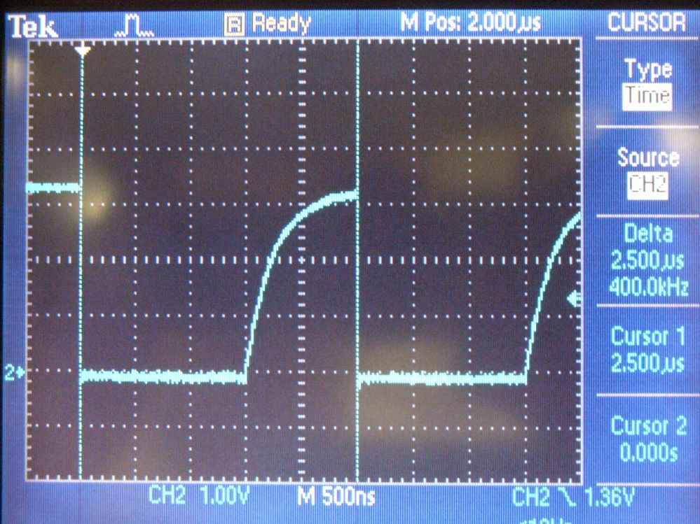

JackyAtFreescal
Senior Contributor II
Without HW modification on EVK, I got this waveform on R115 (SCL) for below register settings.
HW_I2C_TIMING0  HW_I2C_TIMING1   tH     tL     freq.
(0x80058010)    (0x80058020)
0x000d0006      0x00230010       1us    1.5us  400kHz
12,904 Views

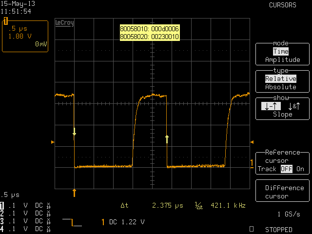

Matt_
Hi Jacky,
I think the slow rise time is the cause of the descrepency as plugging your values into my board gives 421kHz.
The original values I suggested work for me at 400kHz, so I guess the clock rate is very board dependent.
Matt.
