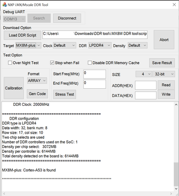

i tried to perform stress test on LPDDR4 RAM using mscale ddr tool . but i got struck in middle
843 Views
srinivas_123

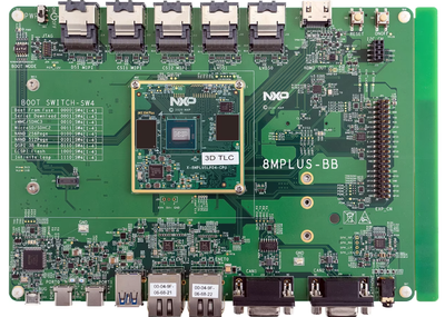

i am using nxp imx8mplus lpddr4 evk.
i am doing stress test on lpddr4 ram using mscale ddr tool
I follow the steps in guide .
step1 :1. Connect the target board to PC host
step 2:. Launch the MSCALE_DDR_Tool.exe in administrator mode
step3:Press Search button in the Debug UART area, then choose the correct UART port
connected to the MX8 Cortex A-Core Debug UART and press Connect button.
step 4:Load DDR initialization script and choose correct downloading options (select the default one present in script folder)
step 5:Press Download button and wait for target board ready
in this step I am stuck here . please help me out.
calibration button is not enabled to perform calibrations
 thanks&Regards
srinivas

JorgeCas
Did you put the board on serial download mode?
Best regards.

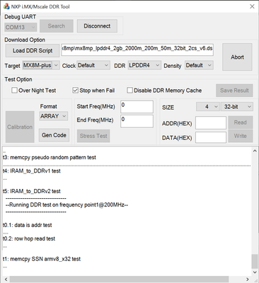

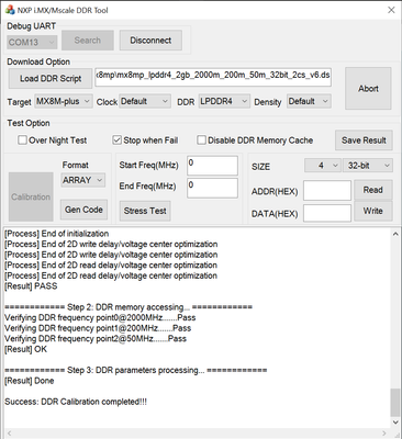

JorgeCas
Please try with the next script <your_installation_path>\script\mx8mp\mx8mp_lpddr4_2gb_2000m_200m_50m_32bit_2cs_v6.ds
Best regards.
