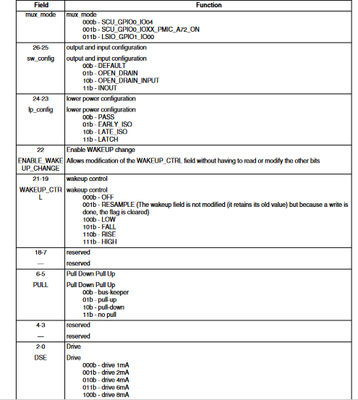

I have used following apis to enable wakeup
    (void) rm_set_resource_movable(pt_sc, SC_R_GPIO_4, SC_R_GPIO_4,
        SC_FALSE);
    (void) rm_set_pad_movable(pt_sc, SC_P_SCU_GPIO0_04, SC_P_SCU_GPIO0_04,
        SC_FALSE);
     err = pad_set(pt_sc, SC_P_SCU_GPIO0_04, 0x600043);
/* Here, after reading we see output value is 0x200043  expected 0x600043 */
     err = pad_get(pt_sc, SC_P_SCU_GPIO0_04,&value);
Here, We are setting wakeup enable and also set the wakeup on low level but We cann't see Wakeup enable.
Details of pads and mux get from the TRM as proivided earlier.
Can you please let me know what we are doing wrong to enable wakeup on gpio from SCFW?
