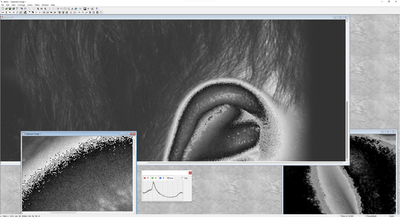

I got image stream through IMX274 -(bayer RGGBx10)-> ISP -> DWE -> MEMORY.
If I set over gain or exposure, Image is changed like pixel value overflow by saturation.
What should I change for this situation. pipeline or isp module setup?

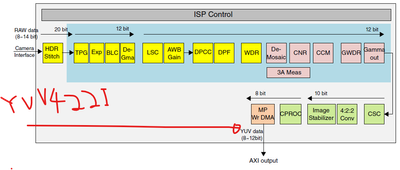

Q3. Where is detailed ISP Diagram?  YUV processing, Bayer Processing, on-off mechanism...

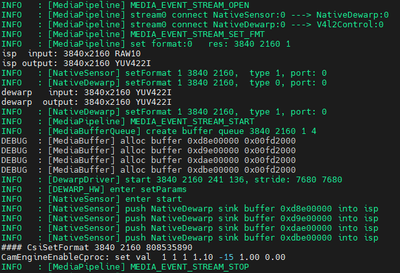

INFO   : [MediaPipeline] MEDIA_EVENT_STREAM_OPEN
INFO   : [MediaPipeline] stream0 connect NativeSensor:0 ---> NativeDewarp:0
INFO   : [MediaPipeline] stream0 connect NativeDewarp:0 ---> V4l2Control:0
INFO   : [MediaPipeline] MEDIA_EVENT_STREAM_SET_FMT
INFO   : [MediaPipeline] set format:0   res: 3840 2160 1
isp  input: 3840x2160 RAW10
isp output: 3840x2160 YUV422I
INFO   : [NativeSensor] setFormat 1 3840 2160,  type 1, port: 0
INFO   : [NativeDewarp] setFormat 1 3840 2160,  type 0, port: 0
dewarp   input: 3840x2160 YUV422I
dewarp  output: 3840x2160 YUV422I
INFO   : [NativeDewarp] setFormat 1 3840 2160,  type 1, port: 0
INFO   : [MediaPipeline] MEDIA_EVENT_STREAM_START
INFO   : [MediaBufferQueue] create buffer queue 3840 2160 1 4
DEBUG  : [MediaBuffer] alloc buffer 0xd8e00000 0x00fd2000
DEBUG  : [MediaBuffer] alloc buffer 0xd9e00000 0x00fd2000
DEBUG  : [MediaBuffer] alloc buffer 0xdae00000 0x00fd2000
DEBUG  : [MediaBuffer] alloc buffer 0xdbe00000 0x00fd2000

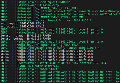

Only, RAW10 -> RAW10 are showing saturate(?) or overflow(?) image.

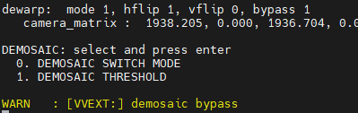

Q2. How to get XML for bypass(no effect)? I copy and edit from /opt/imx8-isp/bin/*.xml.
Not sure what you meant but you could run /opt/imx8-isp/bin/vvext <camera-id> utility then you could navigate to the appropriate sub-menu to bypass the ISP in order to get RAW output.
--> I did excute below.
# gst-launch-1.0 v4l2src device=/dev/video3 ! video/x-raw,width=3840,height=2160,framerate=15/1,pixelformat=RG10 ! waylandsink window-width=800 window-height=450
Like this captured well but AEC, AGC, is not working correctly.
In the i.MX_8M_Plus_Camera_and_Display_Guide.pdf of each release's documentation.
--> As you know, I did download and read file. you guided me through another issues.
1. I don't know how to turn on/off each block on Bayer input - Bayer output.
    I also want to know which block is working or not in this case.
2. I don't know how to setup 'YUV422I input-> output' pipeline and where is start block below diagram?
I just want to get more detailed diagram like this.
From my experience, one should trigger the reset of AEC (menu 4->1), and AGC (menu 5->1) with  /opt/imx8-isp/bin/vvext <camera-id> utility) to have them work correctly.
Also with /opt/imx8-isp/bin/vvext <camera-id> utility

 3. From my experience, one should trigger the reset of AEC (menu 4->1), and AGC (menu 5->1) with  /opt/imx8-isp/bin/vvext <camera-id> utility) to have them work correctly.
--> okay, I will try one more. "stream on" and then "AEC,AGC reset"....
When I setup output pixelformat RG10, AEC,AGC of vvext was not expected to output image.
so I just use  exposure time(4-7) and gain(4-6).
I did apply vvext my application. and I am controling exposure & gain on my application.
so I got that(saturelated) image.
