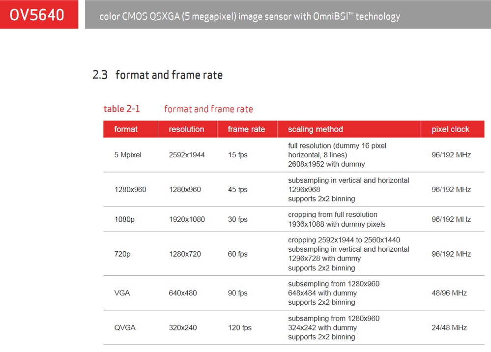

Hello everyone,
I bought the imx8mmevk with the i.MX8M Mini SoC with the MINISASTOCSI accessory, flashed Linux (L4.14.78_1.0.0_ga_images_MX8MMEVK) and managed to stream from the OV5640 with gstreamer successfully.
But I was expecting to be able to use this sensor at 60fps as the datasheet of the sensor specify and the video encoders VP8/H264 are capable of outputting at least 720p60.
I have done a quick search for the cause of this but I see that's it's using 2 mipi_csi lanes

Now I would like to know what is possible to do to get to 60fps with this sensor and from where the limitation is coming.
Is it from some registers in the driver? The clock speed used? Do I need to recompile something with other parameters?

The driver is locked to 30 fps in multiple places like here:
https://source.codeaurora.org/external/imx/linux-imx/tree/drivers/media/i2c/ov5640.c?h=imx_4.14.78_1...
https://source.codeaurora.org/external/imx/linux-imx/tree/drivers/media/platform/mxc/capture/ov5640_...
And many other references to the framerate here
./drivers/media/i2c/ov5640.c
./drivers/media/platform/mxc/capture/ov5640_v2.c
./drivers/media/platform/mxc/capture/ov5640.c
./drivers/media/platform/mxc/capture/ov5640_mipi.c
./drivers/media/platform/mxc/capture/ov5640_mipi_v2.c
./drivers/media/platform/imx8/ov5640_mipi_v3.c
./drivers/media/platform/imx8/ov5640_v3.c

The ov5640 have a driver upstream that supports all camera modes, including 720p 60fps.
I would try to get the upstream driver to work on the kernel you're using.
It can be found here:
linux/ov5640.c at master · torvalds/linux · GitHub
Both drivers utilize the v4l2-subdev system so a drop in replacement should be possible.
Good luck!

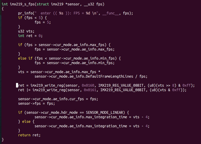

Amal_Antony3331
Hi @diegoadrian
I'm trying to integrate imx219 sensor with iMX8M Plus. I'm able to get the stream but the FPS that I'm getting is only 15 fps @480p. If  I decrease it to 144p, fps increases to 20.
root@imx8mpevk:/opt/imx8-isp/bin# v4l2-ctl -D -d /dev/video2 --list-formats-ext

Gstreamer command that I have used is given below.
Server command:
gst-launch-1.0 v4l2src device=/dev/video2 ! videorate drop-only=true ! video/x-raw,width=640,height=480 ! jpegenc ! rtpjpegpay ! udpsink host=<client_ip> port=1234
Client command
gst-launch-1.0 udpsrc port=1234 caps="application/x-rtp" ! rtpjpegdepay ! jpegdec ! videoconvert ! fpsdisplaysink
Above given is the function to set the FPS.Is it due to whether I have missed any register to configure ?
Any help is appreciated.
