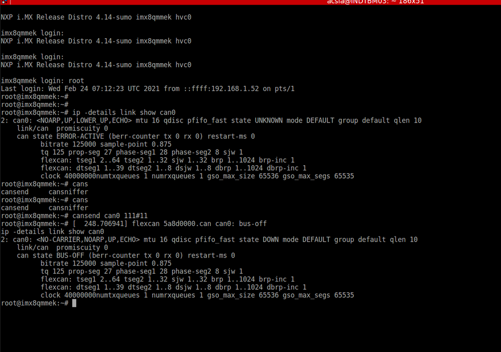

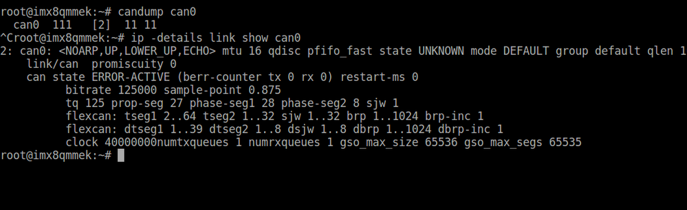

i am using  i.mx8 qm board for the automotive project while testing the things like can communication can bus is going in off state when it doing the communication with host pc but when host pc start the communication first if it sends the message first that time is it is working fine but if first message sending by i.mx board that time can bus is going in the  bus off state

hello while testing i am getting the following errors
when i.mx8 board sent the first message.
while testing from host pc towards i.mx8 board communication is fine and working
