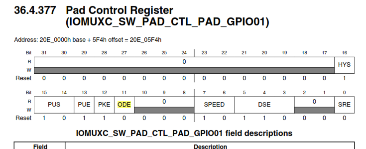

I've been working with the i.mx7 processor for a few years and have always worked around the fact the the GPIO mux doesn't include a ODE bit to enable the gpio as a open-drain output. Does this part just not have a GPIO open-drain  output function? I find it hard to believe and am assuming i am just not looking in the correct place in the reference manuals.
Can someone confirm how to enable ODE for the GPIO, if even possible?
Thanks.
Tim

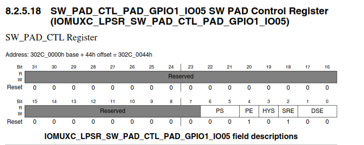

The typical pad control register looks like this (from the mx7S/D RM):
Where from the i.mx6, for example, they pad control looks as follows:

Hello Tim,
   Yes, i.mx7D pads couldn't be set Open Drain IO mode.
   If you really need OD IO, you can do like this:
(1) external pull up to high via a resistor on a PAD
(2) Setting the GPIO to be INPUT MODE
the pin will OUTPUT 1
(3) Setting the GPIO to OUPUT mode
Set the GPIO to ouput 0.
That is to say,  Open Drain mode is realized by changing IO direction of GPIO.
