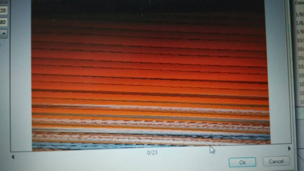

I am working with i.mx6ull csi with tw9900 over bt.656. My camera is NTSC format.
I patch mx6s_capture.c file following guidance(0001-Enable-CSI...) from below link.
imx6ul tw9990 issue
However, I am unable to get the correct image format. This is what I can capture so far.

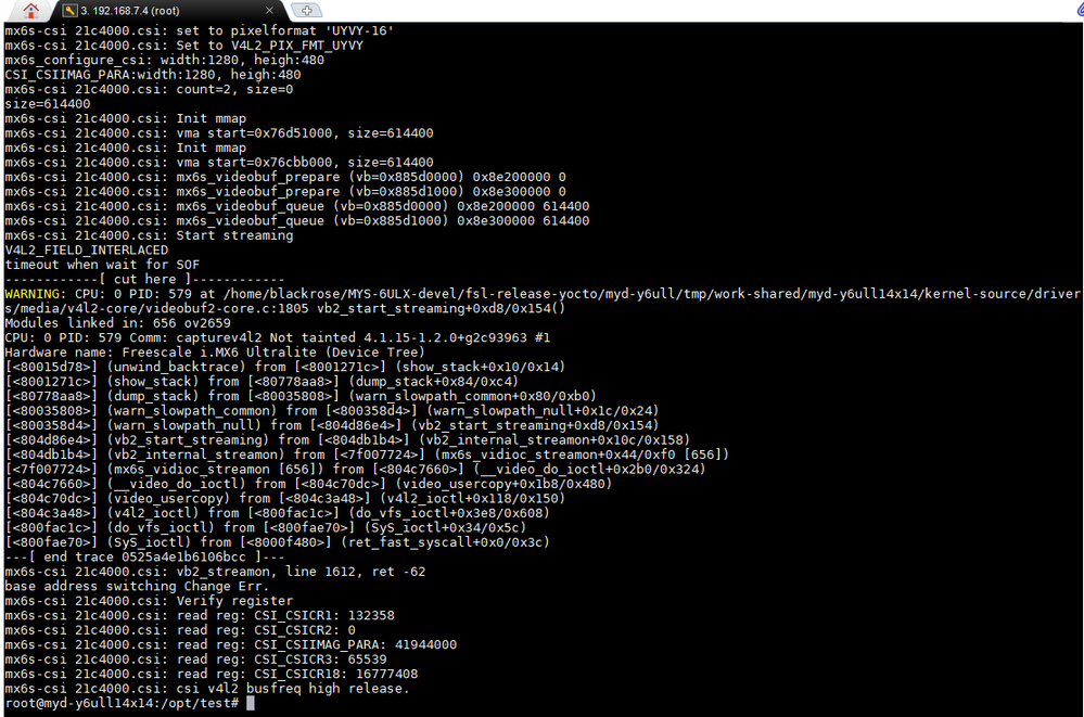

hoanganh
Yes, i know that.
I modified mx6s_capture.c follow your source code. Seem it work!
But i only capture 1 frame, then "timeout when wait for SOF". If i reboot the imx6ull, i can capture again but only 1 frame.
8,676 Views
tkcheng01
I seems to have similar problem before, but I can't be sure as it is quite some time ago.
I vaguely recall I have the SOF message. After that I recheck my bt.656 source and fix on my source. Then everything works. So at this moment, I can only suggest you to make sure your bt.656 source is no issues (e.g. perhaps connect to a receiver and prove working)

hoanganh
Thanks for response.
At first capture after power on, i have SOF interrupt. But with second capture (ioctl VIDIOC_STREAMON), can't detect SOF util restart system.
Now, do you have bt656's hardware (Camera, imx6ull)?
BT.656
Can you compile my driver and app on user space. Help me testing to make sure software is OK. I thinks haven't problem with my hardware!

tkcheng01
Your image, is very similar to my image in the first post. So I suggest you validate your bt.656 source to ensure the output is correct. At this moment I am unable to assist you by running your image on my hardware.
As for my latest tw9900, I had shared on above post (look for 12-july)
8,676 Views
hoanganh
Yeah, look like vsync signal is lost.

Hi TK, this is log when i compile module kernel
vu@VuHoangAnh:~/Desktop/1.IMX6ULL/build/04-Source/MYiR-iMX-Linux$ make modules
CHK include/config/kernel.release
CHK include/generated/uapi/linux/version.h
CHK include/generated/utsrelease.h
make[1]: 'include/generated/mach-types.h' is up to date.
CHK include/generated/bounds.h
CHK include/generated/asm-offsets.h
CALL scripts/checksyscalls.sh
CC [M] drivers/media/platform/mxc/subdev/656.o
drivers/media/platform/mxc/subdev/656.c:296:27: error: field 'vb' has incomplete type
struct vb2_v4l2_buffer vb;
drivers/media/platform/mxc/subdev/656.c: In function 'mx6s_videobuf_queue':
drivers/media/platform/mxc/subdev/656.c:743:33: error: implicit declaration of function 'to_vb2_v4l2_buffer' [-Werror=implicit-function-declaration]
struct vb2_v4l2_buffer *vbuf = to_vb2_v4l2_buffer(vb);
drivers/media/platform/mxc/subdev/656.c:743:33: warning: initialization makes pointer from integer without a cast [-Wint-conversion]
In file included from include/asm-generic/bug.h:13:0,
from ./arch/arm/include/asm/bug.h:61,
from include/linux/bug.h:4,
from include/linux/thread_info.h:11,
from include/asm-generic/current.h:4,
from arch/arm/include/generated/asm/current.h:1,
from include/linux/mutex.h:13,
from include/linux/notifier.h:13,
from include/linux/busfreq-imx.h:12,
from drivers/media/platform/mxc/subdev/656.c:24:
include/linux/kernel.h:812:48: warning: initialization from incompatible pointer type [-Wincompatible-pointer-types]
const typeof( ((type *)0)->member ) *__mptr = (ptr); \
drivers/media/platform/mxc/subdev/656.c:745:28: note: in expansion of macro 'container_of'
struct mx6s_buffer *buf = container_of(vbuf, struct mx6s_buffer, vb);
include/linux/kernel.h:812:48: note: (near initialization for 'buf')
drivers/media/platform/mxc/subdev/656.c: At top level:
drivers/media/platform/mxc/subdev/656.c:1050:21: warning: initialization from incompatible pointer type [-Wincompatible-pointer-types]
.queue_setup = mx6s_videobuf_setup,
drivers/media/platform/mxc/subdev/656.c:1050:21: note: (near initialization for 'mx6s_videobuf_ops.queue_setup')
drivers/media/platform/mxc/subdev/656.c: In function 'mx6s_csi_frame_done':
drivers/media/platform/mxc/subdev/656.c:1097:5: error: 'struct vb2_buffer' has no member named 'timestamp'
vb->timestamp =ktime_get_ns();
drivers/media/platform/mxc/subdev/656.c:1098:25: error: invalid type argument of '->' (have 'int')
to_vb2_v4l2_buffer(vb)->sequence = csi_dev->frame_count;
cc1: some warnings being treated as errors
scripts/Makefile.build:264: recipe for target 'drivers/media/platform/mxc/subdev/656.o' failed
make[4]: *** [drivers/media/platform/mxc/subdev/656.o] Error 1
scripts/Makefile.build:403: recipe for target 'drivers/media/platform/mxc/subdev' failed
make[3]: *** [drivers/media/platform/mxc/subdev] Error 2
scripts/Makefile.build:403: recipe for target 'drivers/media/platform' failed
make[2]: *** [drivers/media/platform] Error 2
scripts/Makefile.build:403: recipe for target 'drivers/media' failed
make[1]: *** [drivers/media] Error 2
Makefile:947: recipe for target 'drivers' failed
make: *** [drivers] Error 2
Thanks for your help!
