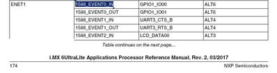

I find some mismatch betweent hardware and the SDK driver.
In the schematics, the ENET1_nINT is connected to SNVS_TAMPER5. In the SDK2.0 the boards\evkmcimx6ul\driver_examples\enet\txrx_transfer\pin_mux.c, there define "{pin_num: K13, peripheral: ENET1, signal: enet_1588_event0_in, pin_signal: GPIO1_IO00}".
In fact the pin SNVS_TAMPER5 that only can be set to GPIO5_IO05 in the IOMUX, can't be set to  enet_1588_event0_in.
I can't understand how this work , Does anybody know?

ENET1_nINT is interrupt from KSZ8081 (U1501 SPF-28616 i.MX6UL EVK schematic),
it is connected to processor gpio and can notfy processor about KSZ8081 state.
In linux seems such codes are not implemented.
igor

Hi Joey
seems there is some misunderstanding as define "{pin_num: K13, peripheral: ENET1, signal: enet_1588_event0_in, pin_signal: GPIO1_IO00}" refers to
while ENET1_nINT is connected to SNVS_TAMPER5 is used for GPIO5_IO05 interrupt.
igor

Thank you for your answer. Then what is the use for ENET1_nINT PIN? I search the pin-defines in u-boot codes and SDK codes, find 'SNVS_TAMPER5  for GPIO5_IO05' not defined in enet module. Is that means this pin is not needed?
