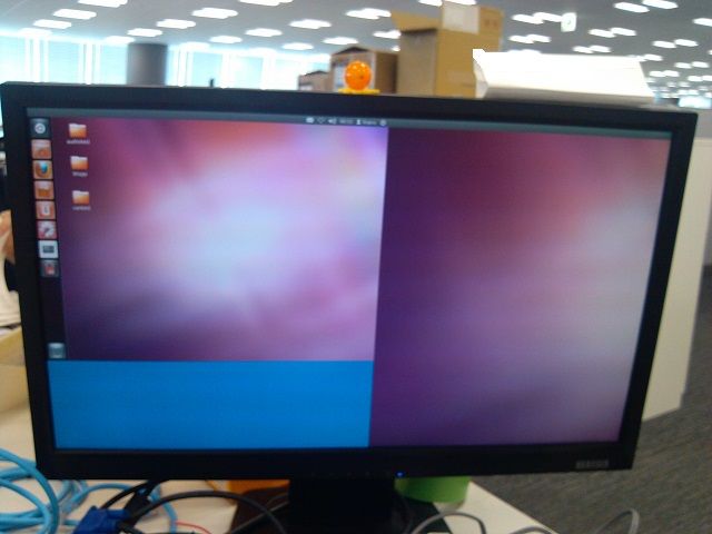

Hi, all
I want to use ubuntu with dual display on i.mx6q board.
And use LVDS as the primary dispaly and  HDMI as the second one.
My u-boot's kernel parameters is as bellow:
video=mxcfb0:dev=ldb,LDB-XGA,if=RGB666 video=mxcfb1:dev=hdmi,1920x1080M@60,if=RGB24
And my x window configure file is as bellow:
Section "InputDevice"
        Identifier      "Generic Keyboard"
        Driver          "kbd"
        Option          "XkbRules"      "xorg"
        Option          "XkbModel"      "pc105"
        Option          "XkbLayout"     "us"
EndSection
        Identifier      "Configured Mouse"
        Driver          "mouse"
        Option          "CorePointer"
EndSection
Section "Device"
        Identifier      "LVDS"
       Driver          "vivante"
        Option          "fbdev"         "/dev/fb0"
       Option          "vivante_fbdev" "/dev/fb0"
       Option          "HWcursor"      "false"
EndSection
Section "Device"
        Identifier      "HDMI"
        Driver          "fbdev"                        ///////////////  If i use "vivante", X window start will failed, it seems that "vivante" not support two display?
        Option          "fbdev"         "/dev/fb2"
EndSection
Section "Monitor"
        Identifier      "LVDS Monitor"
EndSection
Section "Monitor"
        Identifier      "HDMI Monitor"
EndSection
Section "Screen"
        Identifier      "LVDS Screen"
        Monitor         "LVDS Monitor"
        Device          "LVDS"
EndSection
Section "Screen"
        Identifier      "HDMI Screen"
        Monitor         "HDMI Monitor"
        Device          "HDMI"
EndSection
Section "ServerLayout"
        Identifier      "Dual Layout"
        Screen 0        "LVDS Screen"
        Screen 1        "HDMI Screen" RightOf "LVDS Screen"
        Option          "Xinerama"  "on"
EndSection

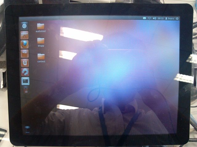

Then i get the two display worked, But somthing is wrong.
On the left of HDMI display there is a copy of lvds.
Is my settings wrong?
Do you know about this?
Thank you

we donot have the multiple display feature supported yet in X11 on i.MX6. Other option is to use wayland-weston

PrabhuSundarara
I'm not sure whether you are using QTWaylandCompositor or Weston. If you are using Weston, extending the displays will be possible by adding outputs, which you can see the reference from compositor-drm.c.I'm not sure how to do it using QTWayland.
6,867 Views
PrabhuSundarara
using FBDEV EXA, is it possible to extend or clone, when the resolution of the displays are same. When the resolution is same and if you want to use 2 LVDS, it can be achieved by ldb=dul0 in the uboot argument.
For the different resolution and extended display, Xrandr extension support is needed, which Vivante EXA is not supported currently. It will be available in the future releases (end of 2013).
