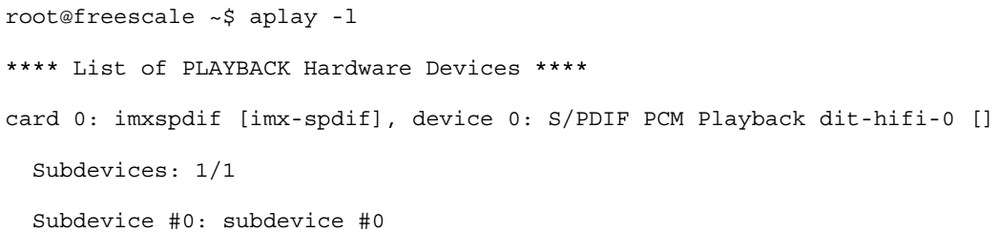

In Linux_Reference_Manual.pdf, about the spdif output driver, when use aplay -l,it will be
but, my result is different with snd-soc-dummy-dai-0, not "Playback dit-hifi-0".
I also check the sabreauto reference board,it is also "snd-soc-dummy-dai-0", Why?

Hi Gao,
Glad that you fixed the problem. Regarding the difference between output showed in Linux_Reference_Manual.pdf and the output showed on board it is caused by change
[PATCH] ASoC: imx-spdif: Use snd-soc-dummy CODEC driver to link card
I will update the documentation.
