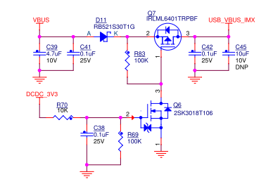

1. In our custom board based on i.mx6ULL, we are only using the board only in USB device mode. For this, the Vbus(in our case it is USB_VBUS_iMX) voltage is necessary to connect to the i.MX's T12 pin??????(from HDG document I came to know that VBUS has no part in Power up sequence)
2. In the NXP EVK, we found a circuit as below. May I know the necessity of the same(Related to concern No:1)?
3. USB Data transfer detection is possible in i.MX? If yes, please provide the necessary details for implementing the same.

1.
  Any of USB_OTG1_VBUS or USB_OTG2_VBUS may be applied for the USB
module of i.MX 6ULL. Your scheme (for USB_OTG1) is correct.
2.
   Basically VBUS may be provided directly from the connector.
3.
   I have some doubt if USB Data transfer detection is possible without data line
analyzing.

At power-up sequence time, is that okay if VBUS reaches i.mx before DCDC_3V3? Also in the absence of DCDC_3V3(Power switch is OFF), Whether the presence of VBUS harms the IC?
