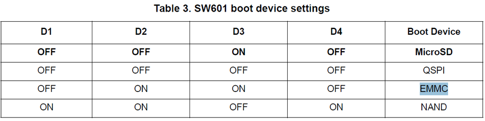

Sorry, I made mistake. It's not the mfgtool2-yocto-mx-sabresd-emmc.vbs for emmc on i.mx6UL-EVK. The default is boot from MicroSD card(USDHC2), there's no vbs file for emmc.
The eMMC interface is connected to USDHC2 of i.MX 6UltraLite. It can support up to eMMC 4.5, but the eMMC device is not populated by default on the EVK board. To boot from eMMC, remove the MicroSD socket and populate the eMMC device, and then change the boot device switch (SW601) settings (OFF,ON, ON, OFF) as shown in the follow:
boot setting from Emmc.PNG.
Additionally, the developer should adjust the BOOT_CFG settings for specified eMMC device by exchanging the pull up/down resistors. See the main board schematic for more information.
