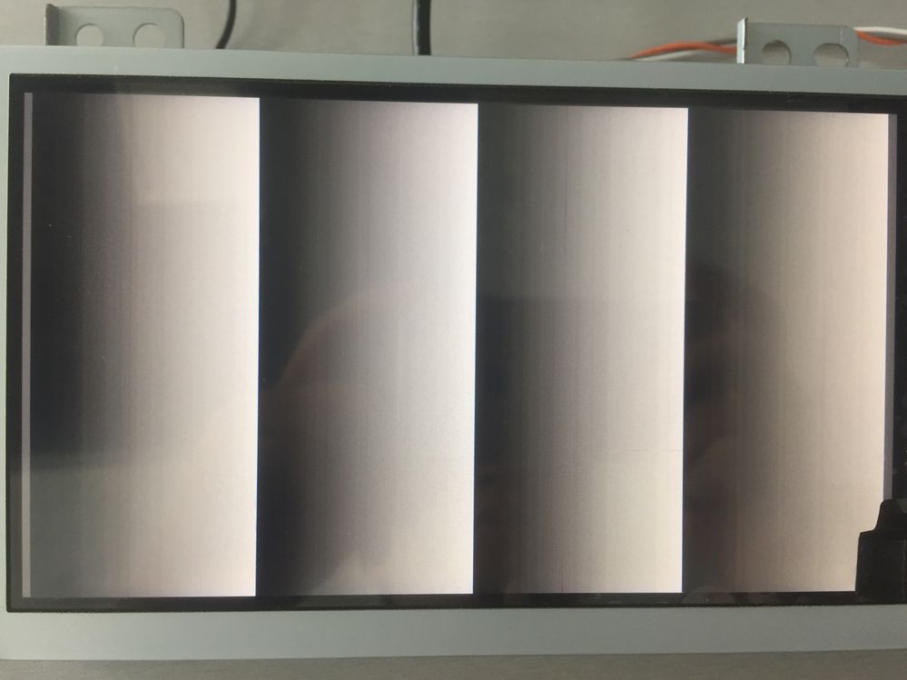

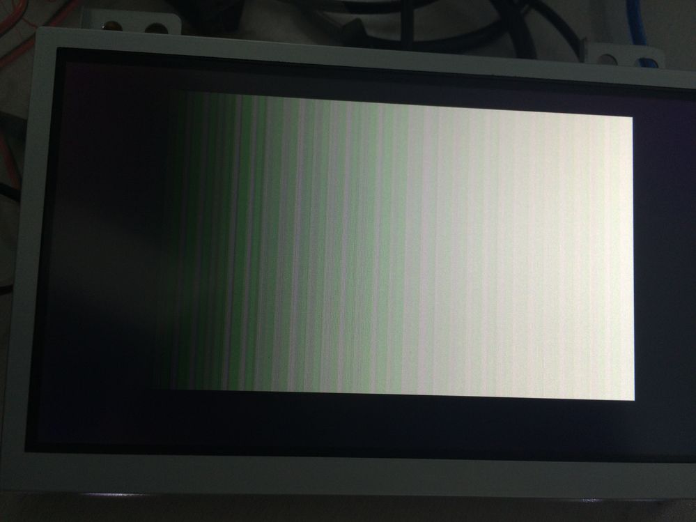

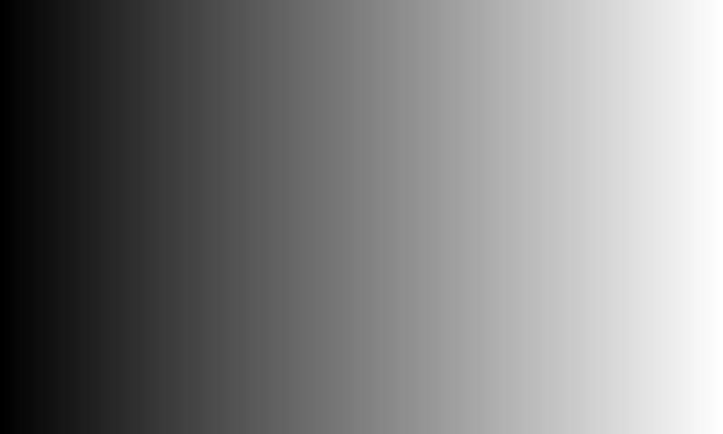

Hi guys,
I got a urgent issue that the navigation unit cannot show the expected performance. The LVDS doesn't connect to i.MX6 directly. The connection chain is i.MX6 <==>TW8838<==>DS90UB927<==>DS90UB928<==>LVDS screen. I corrected clock, bpp and checked LVDS differential voltage of i.mx. I got the display issue as the pictures i attached. Could you please tell me the other detailed possible check points? Thank you.

xiaoqianlin
By setting bpp=16, this issue can be solved.
setenv bootargs console=ttymxc0,115200 init=/init video=mxcfb0:dev=ldb,bpp=16 video=mxcfb1:off video=mxcfb2:off fbmem=10M fb0base=0x27b00000 vmalloc=400M androidboot.console=ttymxc0 androidboot.hardware=freescale androidboot.selinux=disabled and androidboot.dm_verity=disabled

Hi Shawn
please check that expected lcd resolution is adjusted in dts file, look at examples on
https://community.freescale.com/thread/355690
also just for test one can connect lvds lcd directly to i.MX6, to check if signal was not
distorted by TW8838<==>DS90U.. devices.
igor

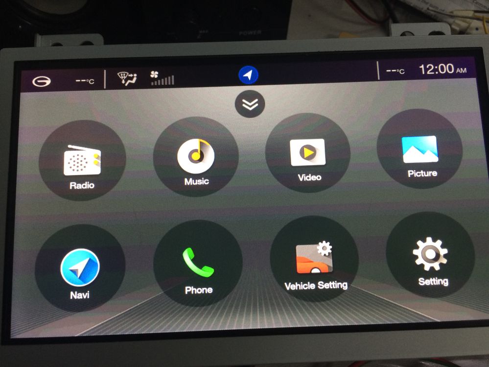

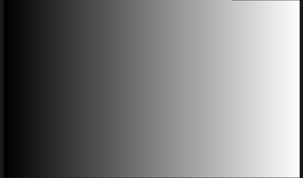

kaifengye
我的屏是24bit模式
使用screencap -p fb.png截图是正常的
但是实际显示效果和fb.png很大差异
