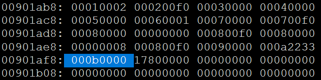

Custom board.
Normally boot from emmc, but sometimes goes to USB downloader.
Normal boot log:
Normal boot logNormal boot log
Failed boot log:
Failed boot logFailed boot log
Difference in entry #19: Jump to the boot image or Jump to the SDP
upd: this problem appears with boot from eMCC and SD too
Sometimes boot fails with following log:

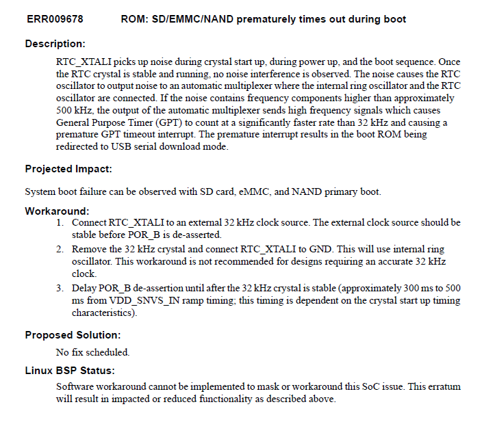

Mestkim
It could be  ERR009678 ROM: SD/EMMC/NAND prematurely times out during boot.
And also suggest you to check the power sequence including emmc power on timing.
2,562 Views
ivan_113
32kHz crystal is removed and RTC_XTALI connected to GND
2,583 Views

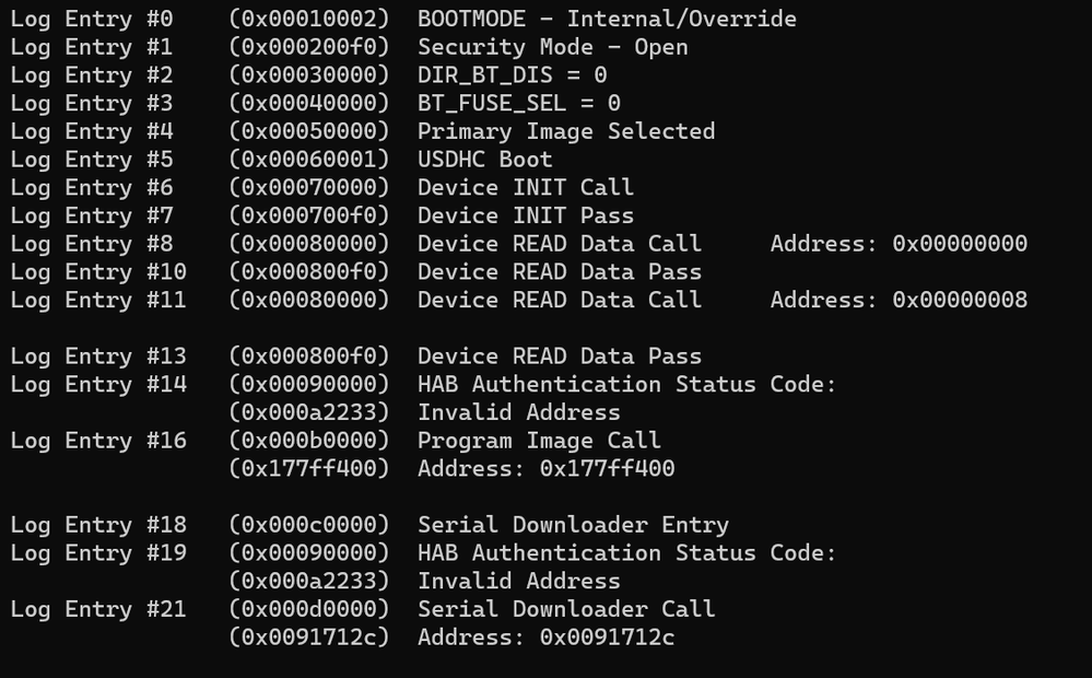

Harvey021
Hi @ivan_113
The problem caused can be various.
Does this issue happen same image?
From ROM log, which seems telling the address in the signature is invalid, you can dump HAB log then share the HAB event.
If not the case above, what BSP you are using, it'd be better to share your schematics to (harvey.yu_1@nxp.com) me for further troubleshooting.
Harvey

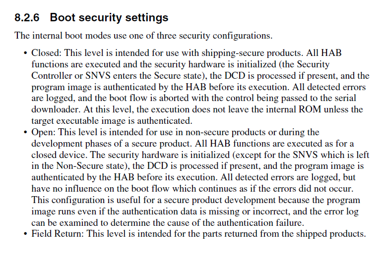

Mestkim
NXP expert,
"The problem caused can be various."  In fact, it cannot be HAB issue in those "various".
The log shows it is an open device.  Dump HAB log and share the HAB event of an open device? For what?
Here is a description in reference manual.
If it is an open device, it always gets authenticated error because "All HAB functions are executed as for a closed device."
On the contrary, what you said "telling the address in the signature is invalid" is a normal ROM log.
Is there any misunderstanding below?
