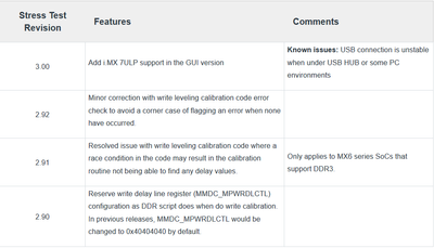

Hi @andrewdyer ,
For the moment the link that you are trying to view is in private and is not accessible for all, the latest version of the stress tool is the 3.0, the listed changes are bellow:
I will attach the latest version for you, hope this help you.
