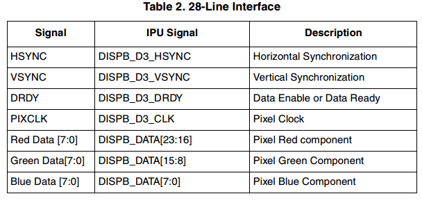

I want to connect triple 8bit Video DAC to i.mx6 for VGA output.
For schematic drawing, I have to know which portion of 24bit parallel display data pin(DISP0_DAT[23:0]) is corresponding to each color component(RED/GREEN/BLUE).
I couldn't find the information in the i.mx6 reference manual.
After searching this community, I found the following information.
Table 2 in Different Display Configurations on i.MX35 Linux PDK(AN3974, http://cache.freescale.com/files/dsp/doc/app_note/AN3974.pdf )
I can guess the following pin map in i.mx6 based on the table.
DISP0_DAT[23:16] => RED[7:0]
DISP0_DAT[15:8] => GREEN[7:0]
DISP0_DAT[7:0] => BLUE[7:0]
But because the table describes only i.mx35(not i.mx6), I'm not sure that my guess is correct in i.mx6.
So I want someone with authority to convince me that I can draw schematic of the i.mx6 board based on the information above.

Display (color bit mapping is software configurable. When configuring display output pins,
the following should be taken into account.
1.
General scheme is shown on Figure 37-32 (Mapping scheme) of the i.MX6DQRM.
2.
From Table 37-25 (DC template's fields description) :
«The MAPPING field holds a pointer to a register holding 3 fields: MAPPING_PNTR_BYTE0_X,
MAPPING_PNTR_BYTE1_X, MAPPING_PNTR_BYTE2_X. This pointers point to sets of OFFSET and
MASK parameters that define the mapping scheme. MAPPING =0 means that mapping is disabled.»
3.
Section 37.4.7.5.1 (Bus Mapping Unit) describes the mapping feature in more details.
On the Figure 37-32 (Mapping scheme), microcode field MAPPING = 2.
That is, register IPUx_DC_MAP_CONF_1 should be used for configuring; please refer to section 37.5.336
[DC Mapping Configuration Register 1 (IPUx_DC_MAP_CONF_1)] of the Reference Manual.
As an example let we set :
MAPPING_PNTR_BYTE2_2 = 2
MAPPING_PNTR_BYTE1_2 = 1
MAPPING_PNTR_BYTE0_2 = 0
then
IPUx_DC_MAP_CONF_15 register should be set as following :
(section 37.5.350 DC Mapping Configuration Register 15 (IPUx_DC_MAP_CONF_15))
MD_OFFSET_1 = 0x0D ; MD_MASK_1 = 0xFC
MD_OFFSET_0 = 0x05 ; MD_MASK_0 = 0xFC
IPUx_DC_MAP_CONF_16 :
MD_OFFSET_2 = 0x16 ; MD_MASK_2 = 0xFC
4.
Please refer to  Chapter 18 (Configuring the IPU Driver) of "iMX6_Firmware_Guide.pdf" in the Platform SDK.
https://www.freescale.com/webapp/Download?colCode=i.MX6_PLATFORM_SDK&location=null
http://www.freescale.com/webapp/sps/site/prod_summary.jsp?code=i.MX6Q&fpsp=1&tab=Design_Tools_Tab
5.
  Please use i.MX6 Datasheet(s) to define typical IPU display output formats.
For example please take a look at section 4.11.10.4 (IPU Display Interface
Signal Mapping) of IMX6SDLCEC (Rev. 2.1, 05/2013).
