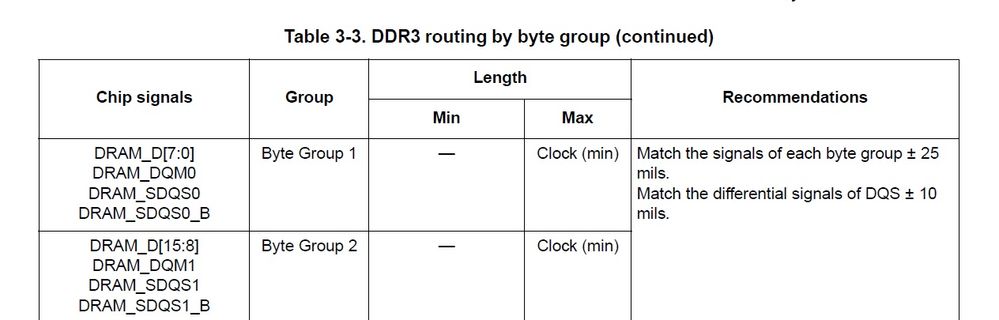

This is really where my question come from

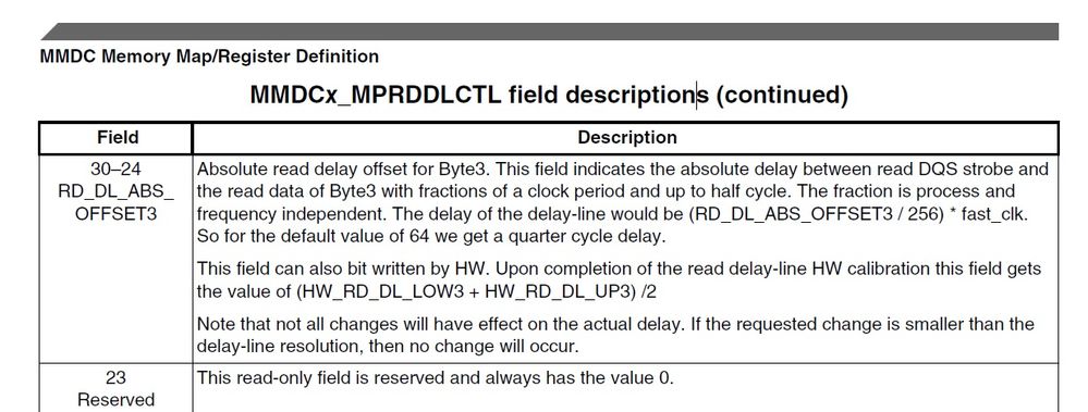

-- per Hardware Guide of i.mx6, Table 3-3. DDR3 routing by byte group, it say "Match the signals of each byte group ± 25 mils". so we need to match the length of DQS with byte lines within ± 25 mils.
And per IMX6DQRM, MMDCx_MPRDDLCTL field descriptions, it say "This field indicates the absolute delay between read DQS strobe and the read data of Byte3 with fractions of a clock period and up to half cycle".
so the DDR controller can adjust the delay line for 127 steps in accuracy of 1/256 Tclk for each step. Typically the Tclk equal to 1ns for a 533MHz DDR3 system. That would make the adjust step in
4ps, and equal to 25 mils in a typical PCB flight time model.
Since we already route the DQS in ± 25 mils with byte lines, so why we still need to do read or write calibration, if our base PCB layout rules are not violated?
