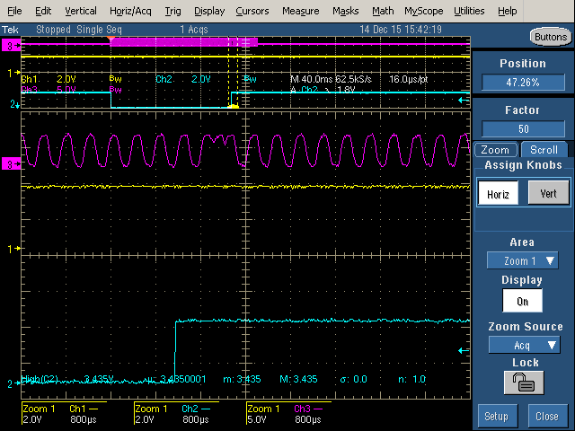

christophk
Hi Stefan,
thanks for the hint.
We've seen this UP/DOWN behaviour on our board some time ago, although it doesn't happen right now.
The phys clock inputs are connected to enet_clk (B4.16). I don't know exactly how the phys are reset (how do I find out?), as I said, it's a debian system with a mainline linux kernel 3.18.0.
I've already checked the reset sequence with an oscilloscope:
The purple signal is enet_clk (B4.16) going to phy clkin (pin 5), the cyan/blue signal ist the ~rst of the phy (pin 15), connected to B4.13 on the cpu. The reset happens about 10s after supplying power to the board. As you can see in the upper part of the scope image, the clock is switched off about 20ms after the end of the reset sequence. Reset duration is about 110 ms.
Does the switching off of the clock signal indicate the bug you hinted at? Or ist this a different situation?
Cheers
Christoph
3,730件の閲覧回数
lategoodbye
Senior Contributor I
The switching off of the clock is not the bug, but it's related to this commit (which causes a regression):
https://git.kernel.org/cgit/linux/kernel/git/stable/linux-stable.git/commit/drivers/net/ethernet/fre...
As you can see this very old (~ Linux 3.14) and not possible to revert easily.
