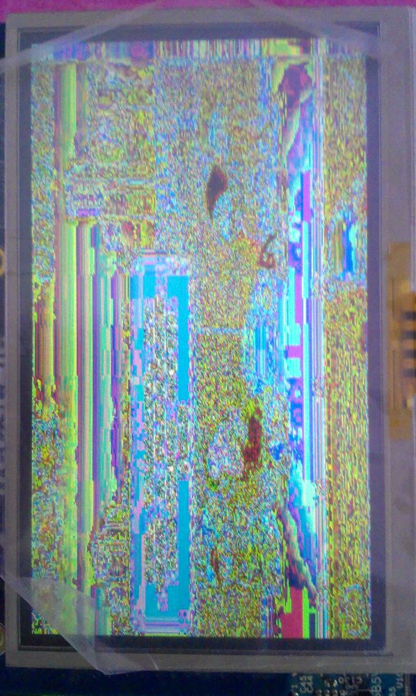

Has anyone used the i.mX233 CPU with 18-bit RGB [6:6:6] LCD Interface??
The default configuration [for the EVK Board] is 24-Bit. How can we configure the Display interface to 18-bit??
What modifications are required in the sources to achieve the 18-bit RGB Interface?

GopiNagaBharath
Thanks for this.
But I am using the 18-bit RGB Interface on i.MX233 EVK itself. The LCD Card on the EVK has an optional connector, which gives out only the 18-bit RGB interface, which is compatible for the SMSUNG LMS430 on EVK Board.
I have tried connecting the LCD to 18-bit interface and changed the interface bus width to 18-bit RGB Interface. As a result, i found that the still images are shown properly, however, the videos are not played properly. When I play the video, the colour information is completely lost and the playback is blurred with different colors.
Do i have to do any other configurations for successfully using the 18-bit RGB Interface?? Below shown is the picture of video shown on the LCD.
