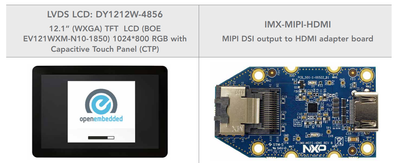

I'm evaluating the purchase of board i.mx 93 evaluation KIT (MCIMX93-EVK).
Looking at quick start guide I can see that we can use the MIPI-DSI interface to connect with a TFT-LCD display. We can also use LVDS interface.
I saw that are suggested some additional accessories:
The questions are:
1) using IMX-MIPI-HDMI can I connect to any HDMI enabled monitor that does fit recommended resolution?
2) What are technical characteristics of "LVDS LCD: DY1212W-4856"? How can I choose a different display that has the same controller built-in? What are the criteria selection in order to choose a part number fully compatible with MCIMX93-EVK?
Thanks in advance,
Marco.

Hi @marco95!
Thank you for contacting NXP Support!
1080p60 MIPI DSI (4-lane),
720p60 LVDS (4-lane),
24-bit parallel RGB
I can send you the datasheet of the display, from now is the only one display supported by our EVK.
