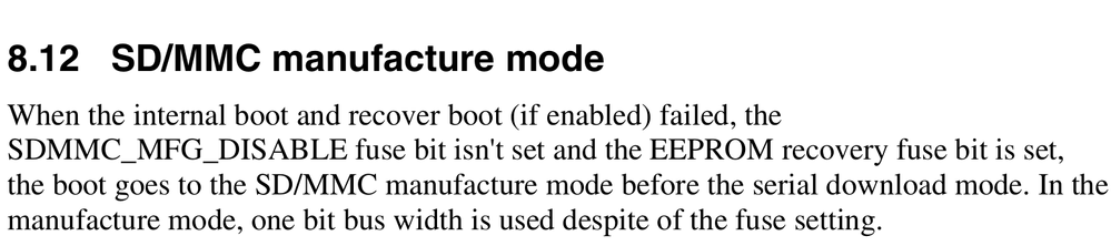

Hi kevin.chuang@youngoptics.com,
As per the below screenshot from RM, the device will go in SD/MMC manufacture mode if internal boot and recovery boot is failed or if boot mode pins are set to serial download mode. But I believe in your case your system is not failing to boot.pastedImage_2.png
What is the value of BOOT_MODE in your case? Do you want to remove the SD Card and flash eMMC? Also, if you want to disable the SDMMC MFG mode please refer Burning eFuses on i.MX6 and i.MX7 - i.MXDev Blog to burn the fuse.
Kunal

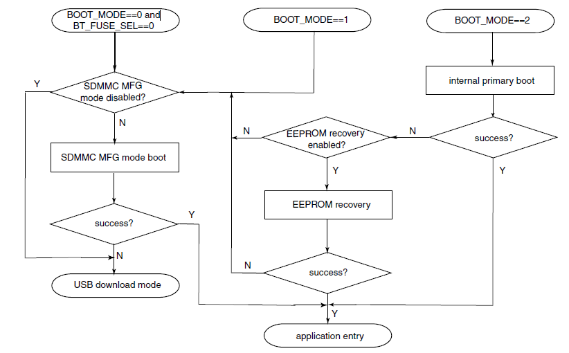

kunalkotecha1
Senior Contributor II
Let me frame as per my understanding and correct me if there is any misunderstanding.
You have a product that initially has an SD Card with flashed images. You are setting the BOOT_MODE to serial downloader mode. With serial download mode and SD Card flashed images you are shipping the product. Now, If you turn on the system, it will boot from SD Card as SDMMC mode is enabled by default.
If you disable SDMMC mode then, the system will directly go to Serial download mode and wait for image. Then you can download the image to eMMC.
However, my concern is lets say once you downloaded the image to eMMC, then you need to set the BOOT_MODE pin to internal boot and eMMC as the boot device. If so, then you will always boot from eMMC and I don't know when the SD Card will be used further. Please clear me if with exact scenario if there is any difference.
Kunal

kunalkotecha1
Hi kevin.chuang@youngoptics.com ,
Okay. As the customer is using serial download then the board will be physically available with him and in this case, I believe if they remove the SD Card from the socket then as per the flow it will scan SD1, and if not found it will jump to Serial Download mode. From next time you can continue with the flow as per your requirement.
Kunal
