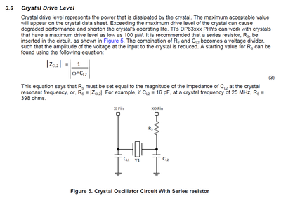

The drive level still concerns me. We want to use a crystal with a drivel level of a 100uW and testing it will not prove whether it works or not. Exceeding the drive level of a crystal will not cause an immediate failure but will cause it to fail long term. Below is a snippet from a white paper which explains what happens when you exceed the drive level. We could put a resistor in series with our crystal to lower the voltage across it. Lowering the voltage across the crystal will prevent us from exceeding the drive level.
Are you certain that the drive voltage is not fixed? If we know the drive voltage then we can determine how large of a resistor we need to put in series with our crystal. We measured the voltage across the crystal with an o-scope on the i.MX eval board and found it to be about 600mV.
Also, could you share the part number of the 24MHz oscillator (Y1) that was used on the eval board (
MIMXRT1060-EVK)?  The part # is not on the BOM in the eval board documentation.
-Greg
