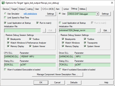

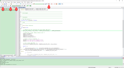

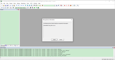

4 回复数
3,956 次查看
victorjimenez
I didn't face any problems when trying to flash and debug an example of the RT1024-EVK SDK with Keil v5.34. When I opened the SDK example, Keil asked me to install the corresponding package. You have to accept install it.
After that, the example opened correctly. From here, first I selected the target flexspi_nor_debug. Then I compiled the application. Once the application is compiled without errors, I load it into my EVK. Finally, I launched the debug session.
Did you follow these same steps?
Victor

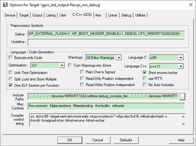

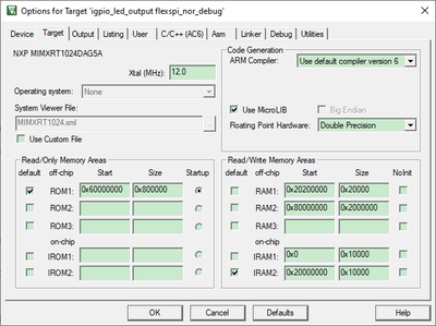

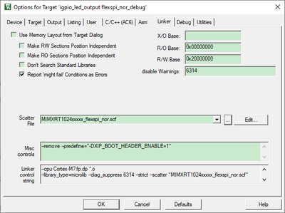

3,951 次查看
srinadh
Please share screenshots of TARGET options window of that project, may be it was helpful to me,
List :
TARGET, C/C++(AC6), ASM, LINKER, DEBUG....

3,925 次查看
victorjimenez
Please see the below images.
Victor
3,921 次查看
srinadh
I have a doubt regarding TARGET menu options:
IMXRT1024 controller have :
24Mhz crystal clock but we selected 12 Mhz,
On Chip FLASH memory was 4MB but we given size 8MB that to also selected off chip memory
