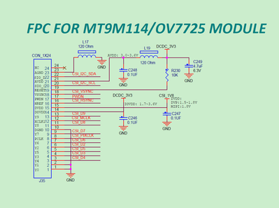

Mc2023
Hi @kerryzhou ,
Thanks for your feedback!
In the meantime, I have also noticed that MIMXRT1060-EVK has a CSI interface. There is also the 1050-EVK.
I have forgotten to mention, I am looking for an EVK composed of a dual core i.MXRT and a csi port. Do you have that?

kerryzhou
You mean RT11XX board, right?
Until now, our EVK for RT11XX are all MIPI interface, no parallel interface.
Maybe you can check the schematic, check the related parallel pins, whether you can use wire connect out or not.
kerry

kerryzhou
Hi @Mc2023 ,
   As I know, our EVK with dual core are all the MIPI interface, not the parallel interface.
  But, our RT11XX with dual core can support the parallel interface, just not fan out it to the elcd RGB interface, the parallel interface is the same as the MIMXRT1060-EVK, MIMXRT1050-EVKB board.
  So, if you have the RT1060, RT1050 board, you also can use that board test it, then to the dual board, you can design your own board.
Wish it helps you!
