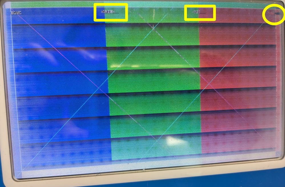

I observe some flickering and others glitches when trying to setup a parallel LCD with imx93.
I attached a picture of the output of the fb-test command. In the yellow rectangles there are glitches around pixels set to print text "GREEN" and "RED". In the yellow circle there is a glitch, as if lines where pixels were set (for the text) were shifted left.
fb-test outputfb-test output
The framebuffer is configured as XRGB8888 (bpp 32), size 800x480. The bus format is configured as rgb888.

As far as I know I configured things the right way, but maybe I missed something. Could you please advise ?
The driver used is lcdifv3, from linux 6.1.55.

I guess this issue is due to clock frequency check your clock.
