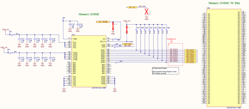

We have a custom board based on the i.MX 93 (MIMX9352CVVXMAB), and we have an 8 GB eMMC device (Alliance ASFC8G31MA-51BIN) connected to SD1 in the same fashion as on the EVK and FRDM boards.  I've built a U-Boot and kernel image for our board; the BSP right now is just a clone of the EVK BSP with memory speed (in U-Boot) ratcheted down to 1866 MT/s (a topic for another post).  I'm able to load U-Boot onto our board via UUU, but when it runs, I get the output below (see attachment).  Importantly, I see this:
MMC: no card present
I played some "Spot the Difference" between our schematics and the EVK and FRDM schematics, given that Alliance makes some specific recommendations for their chips.  We made sure that there is no pullup on SD_CMD or SD_DATA[0-7], and no series resistor on SD_CLK.  To the best of my ability to verify, we appear to have the exact same circuit on our board for eMMC as the EVK and FRDM boards do, but U-Boot appears unconvinced of this fact.

Could you please share your schematic related to the MMC and and the U-boot device tree?
Salas.

Here are the relevant sections of the schematic:
Schematic, Processor MMC sectionSchematic, Processor MMC sectionSchematic, MMC DeviceSchematic, MMC Device
Of note: We replaced R90 (SDI_CLK in series) with a zero ohm, and also removed R79-R86 (SDI_DATAx pullups).  I have not yet modified the device tree for our target; we are using the stock bootloader and device tree as defined for the i.MX 93 EVK.  And to reiterate, the U-Boot "mmc" test commands do appear to detect and read a functioning eMMC device (see my original post).  It's just that UUU and U-Boot are refusing to flash eMMC with my supplied images... U-Boot loads, but no flashing activity takes place.

As the BSP is the same as the EVK, could you pelase double check that the Device tree used in U-boot has the property non-removable; in the USDHC1 interface?
Also, if possible, share your BSP and U-bot version to align with your environment.
Salas.
