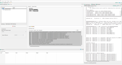

On the EVK, we successfully validated DDR configuration with the Config Tool via USB.
On our custom board, when we try to validate the DDR configuration (generated with the i.MX Config Tool), the communication over USB1 to the i.MX is not being established.
So my questions are:
- Is it actually correct to start with DDR configuration before flashing the bootloader, or should the bootloader be flashed first?
- If DDR configuration is indeed the first step, why would the Config Tool validation fail on our custom board while it works fine on the EVK?
Any guidance on the proper bring-up sequence and potential causes of this USB communication issue would be very helpful.

This error indicates a failure during DDR application loading to the board. There are several reasons for this behavior.
1. The board didn't power-up correctly. Was it verified that all the rails come up in the correct order and to the desired voltages? Can the board be seen in the PC's device manager as HID device?
2. Bootrom is not responding anymore. This typically happens when there are USB connection issues. Any chance trying this with a different USB cable and PC?
3. Do multiple boards behave this way or just one unit?
4. Could you please share the exact part number you are using?
Best regards.

Thank you for the clarification, Indeed the problem was in the communication.
I have solved that issue and the comm is starting however im getting another error :
ERROR memtool.common.base_test Application load ended with exception: Download incomplete due to configuration error!
Can you please guide me to what it potentially could be ?
Thank you in advance !

Khaled_Gued
The board is powered up correctly and it is seen as HID Device by the PC
I tried with different USB and PC, sale problem
For now we are only testing with one board, I am going to test with another one
the part number I am using is the PIMX9352AVTMAB

Your workflow understanding is correct.
You need to run the DDR stress test to generate de initialization/timing to build your bootloader/image. During the DDR stress test, the board will be in serial download mode.
The error log you are getting is caused by unstable UART COM connection to your board from PC host. Please check that you are connecting your board to the correct COM port and also please you schematic connections.
Best regards.
