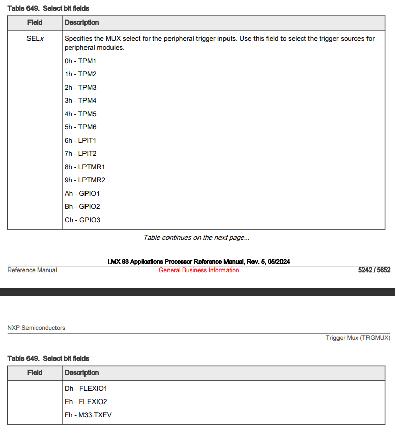

This appears to be documentation describing the input trigger functionality of the ADC to synchronize to an external event. I am asking about the option to output a control signal to an external analog multiplexer to enable additional ADC channels.

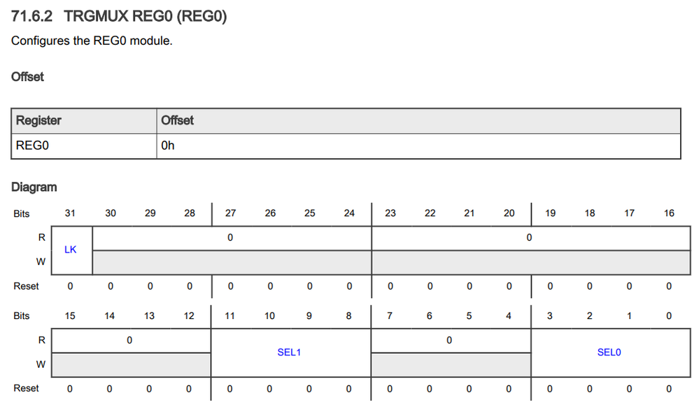

Thank you for your interest in NXP Semiconductor products,
Triggers can be muxed according to the register sent below and the values would be according to the table attached.
