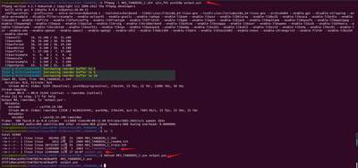

Hi NXP,
We used the mxc_v4l2_vpu_enc.out tool to decode successfully, but the MD5 check failed!
mxc_v4l2_vpu_enc.out decode successfully:
/unit_tests/V4L2_VPU/mxc_v4l2_vpu_enc.out \
 parser --key 0 --name sp2_bt_b.h264 --fmt h264 \
decoder --key 1 --source 0 \
 convert --key 2 --source 1 --fmt I420 \
ofile --key 3 --source 2 --name output.dec.yuv
MD5 failed:
The following videos all have the same problem:
sp2_bt_b.zip
SP1_BT_A.zip
MR4_TANDBERG_C.zip
MR5_TANDBERG_C.zip
FM1_FT_E.zip
CVFC1_Sony_C.zip
h. 264 video source website: https://www.itu.int/wftp3/av-arch/jvt-site/draft_conformance/AVCv1/
Software version: Yocto Project LF5.15.32_2.0.0
Could you please help me see the cause of the problem?  Thank you very much!

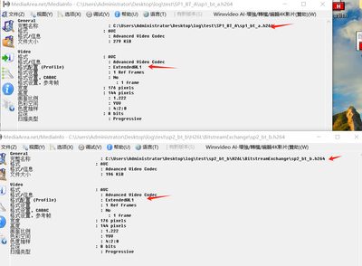

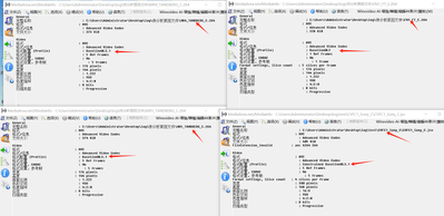

I found that the profile for SP1_BT_A.zip and sp2_bt_b.zip are Extended profile. Is this SOC not supported?
But MR5_TANDBERG_C.zip, MR5_TANDBERG_C.zip, FM1_FT_E.zip are Baseline profile. Is SOC supported?
And CVFC1_Sony_C.zip is the Constrained Baseline Profile, which is supported by this SOC.
The configuration is shown in the following figure:

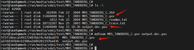

I have a feeling you misunderstood what I meant. I need to convert H.264 video to YUV video.
My test steps are as follows:
1. Download MR5_TANDBERG_C.zip and unzip it
2. cd MR5_TANDBERG_C directory
3.  convert H.264  to YUV:
 parser --key 0 --name MR5_TANDBERG_C.264 --fmt h264 \
4. The md5sum command compares the MD5 checksum:
The check value of the YUV video is the same after the correct conversion. However, the MD5 checksum is different now.
We can use ffmpeg to achieve the conversion, the command:
ffmpeg -i MR5_TANDBERG_C.264-pix_fmt yuv420p output.yuv
So we want to find out why the VPU failed to convert this video. Thank you very much!

We use Linux 6.6.36_2.1.0 firmware. The conversion of CVFC1_Sony_C.zip was successful. However, the conversion of MR5_TANDBERG_C.zip, MR5_TANDBERG_C.zip, FM1_FT_E.zip still fails. But MR5_TANDBERG_C.zip, MR5_TANDBERG_C.zip, FM1_FT_E.zip are Baseline profile. Is SOC supported?

joanxie
confirmed that this issue isn't related to the profile, this is current vpu firmware couldn't support this streaming, because recorder depth of this streaming is bigger than the max size which is calculated by the vpu firmware, so the result md5sum isn't correct, you can use MR3_TANDBERG_B
