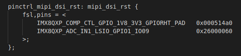

My question is, when I try to config ADC_IN1 as GPIO1_IO09, I cannot control it.
This is my dts file.
or
When I set HIGH or LOW with GPIO1_IO09, it doesn't change.
Below is what I tried to do.
Even I read below article already, however it isn't help me.

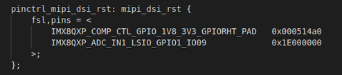

hansung_jung
I solved this.
Due to incorrect pinctrl group, I couldn't.
I referred below.

hansung_jung
I solved this.
I referred below.

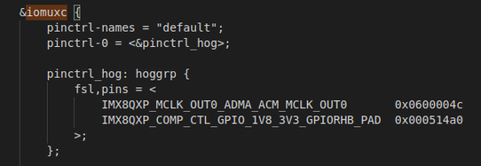

1,342 次查看
Manuel_Salas
Hello @hansung_jung
Could you please share what BSP are you using?
Also, if possible, send the device tree file.
Best regards.
Salas.
1,308 次查看
hansung_jung
Hello Alejandro,
Thanks for your reply.
I am using custom BSP using IMX8QXP.
And I send to you device tree file attached.
Please check "pinctrl_mipi_dsi_rst" part.
