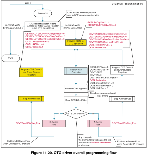

The OTG driver flow requires GHWPARAMS6.SRPSupport=TRUE before proceeding as described in reference manual. But in case of iMX8M SOC, It's false !!. So Is it really possible to support OTG role switch based on OTG ID in iMX8M ?
Following steps describe overall programming flow as per reference manual:
1. During global initialization, read the GHWPARAMS6 register to see if SRP support
is enabled in the configured core. If SRP support is enabled, then proceed with the
OTG programming flow by programming USB_GCTL[PRTCAPDIR] as 2'b11. If
SRP support is not enabled, do not proceed further in the OTG programming flow.
The configured device must at least support SRP for cable connection-based
(Connector ID) role of operation.
2. Initialize the ADP controller as explained in ADP programming flow.
3. The OTG 2.0 state machine is initially in B-IDLE if IDDIG is 1, or A-IDLE if
IDDIG is 0. Enable USB_OEVTEN[ConIDStsChngEvntEn] for any change in the
Connector ID status.
4. Initialize the OTG control and configuration register to default values.
5. Read the OSTS register to find out the current status of the Connector ID
(ConIDSts). After power-on or soft reset, the ConIDSts will be valid only after the
PHY delay from IDPULL=1 to IDDIG active and any filter delay for IDDIG inside
or outside the USB 3.0 core.
6. If USB_OSTS[ConIDSts] is 1, the OTG 2.0 state machine is in B-IDLE, follow the
B-Device flow. Otherwise, if OTG 2.0 state machine is in A-IDLE, follow the A-
Device flow.
7. When there is any connector ID (IDDIG) change resulting in
USB_OEVT[ConIDStsChngEvnt], then exit the A-Device/B-Device flow. Stop the
active driver and re-initialize the OTG control and status registers.
