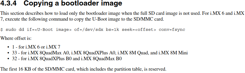

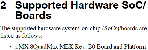

Because i.MX8QM has different u-boot image offset based on differenet revision.
And Android P9 only support B0 revision.
According to below u-boot message, is it mean MEK revision is A0?
U-Boot 2017.03-4.9.51_8qm_beta2_8qxp_beta+gda8c9e0 (Oct 16 2018 - 12:11:51 +0800)
CPU: Freescale i.MX8QM revA A53 at 1200 MHz at 25C
Model: Freescale i.MX8QM MEK
Board: iMX8QM MEK
Boot: SD1
DRAM: 6 GiB

Hi m.c.
right.
Also one can obtain latest marking info in local nxp marketing office.
