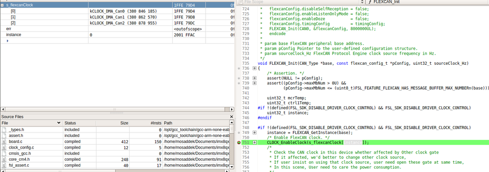

The Function in M4 try to enable the clock in CM4 for FlexCAN1 using kCLOCK_DMA_Can1
/* Enable FlexCAN clock. */
CLOCK_EnableClock(s_flexcanClock[instance]);

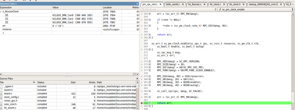

Then the Function Below try to verify the kCLOCK_DMA_Can1 resource with SCFW
  • brief Enable the clock for specific IP, with gate setting.
  • param name Which clock to enable, see \ref clock_ip_name_t.
  • param gate 0: clock always on, 1: HW auto clock gating.
  • return true if success, false if failure.
err = sc_pm_clock_enable(ipcHandle, LPCG_TUPLE_RSRC(name), SC_PM_CLK_PER, true, (bool)gate);

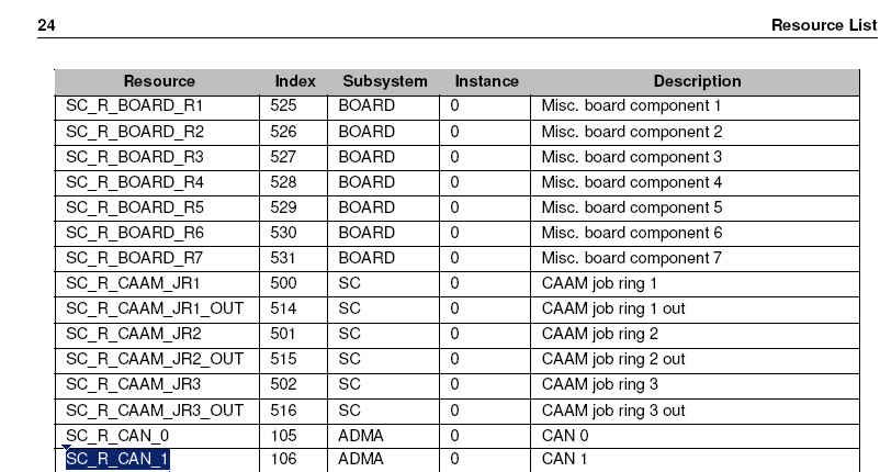

Then it returns an error message: -->SC_ERR_UNAVAILABLE 6U /!< Unavailable (out of resources) /
This means the m4 tries to communicate with SCFW for VALID resouce or dma_clock for CAN1, and this instance is missing in SCFW.
The reason for this failure is when CAN1 is enabled it tries to enable the clock gate with kCLOCK_DMA_Can1 . This is not being implemented in SCFW.

Thanks a lot for your reply. The resouce list has CAN_1 as you have mentioned in your reply, I have also initialized the resources for CAN_0 and CAN_1 for m4 in SCFW:
SCFW:
BRD_ERR (rm_set_resource_movable( pt_boot, SC_R_CAN_0, SC_R_CAN_1,
SC_TRUE));
The screenshot that I provided is also from sc_fw_api_qx_b0.pdf but from CLOCK list:

Initialized CAN1 in similar way as CAN_0. Does not work. As it cannot enable clock for FLEXCAN_1
When sc_pm_clock_enable function tries to enable the clock Gate, it sends an error "6" -> Unavailable (out of resources)

Found a bug in the driver: [fsl_flexcan.h]
FIX: -->  kCLOCK_DMA_Can1 = LPCG_TUPLE(SC_R_CAN_0, ADMA__LPCG_CAN1_IPG_CLK_BASE), /*CHanged  the SC_R_CAN_1 --> SC_R_CAN_0 source*/
Now the clock is enabled for ADMA__LPCG_CAN1_IPG_CLK_BASE
  • But still the CAN1 is not enabled
    base->MCR |= CAN_MCR_MDIS_MASK;
    Error : /* Wait FlexCAN enter low-power mode. */
    while (0U == (base->MCR & CAN_MCR_LPMACK_MASK))
