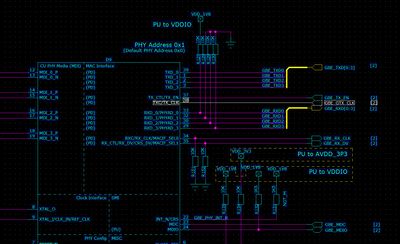

I am currently evaluating a design that utilizes the NXP platform #i.MX8Mini processor. However, I have encountered a problem with the Gigabit Ethernet after a few months of usage with prototype boards. Please refer to the following pictures for a better understanding of the connection.

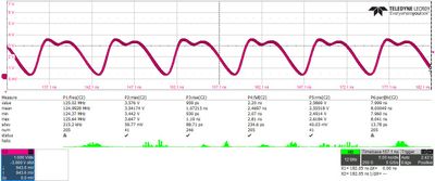

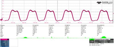

The issue is that although Gigabit communication appears to be established between my board and the Ethernet switch, it refuses to function. In contrast, 10/100-T base communication appears to be working fine. Upon measuring the net_rgmii_txc signal, it is evident that the signal has a 64% duty cycle, which falls outside the acceptable range specified in other specifications. I would like to clarify that the measurement was taken on the pad (AG24), and the trace is entirely cut off from the PHY.

Please help me to answer a few queries as listed below:
1. Are you observing the same behavior on all custom boards?
2. If I understood correctly, the RGMII was working fine before and the issue is being faced now. Please correct me if I am wrong.
3. The clock waveform doesn't look to be in a good shape. Do you have the clock waveform captured when the RGMII was working fine previously?

the boards worked well for periods of more than a month before they became problems. and we have clock signals measured in the picture below on the boards working well. phytest--00018.jpg
  •  we have verified that the Tx clock is problem, by a test providing an external patched 125MHz clock signal to the PHY, then ethernet worked as intended. we even now that clock signal is corrupted at point on the Pad of the MAC@CPU. due to this we need answer for many questions like
