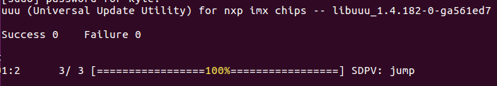

We refer vic_table.c(vendor\nxp-opensource\uboot-imx\drivers\video\nxp\hdp) to configure HDMI 1920x1080 video timing in DTS of uboot.
We can build the image successfully, but can't flash the image.
The following picture shows the flash progress stops at SDPV:jump.
Please check out the error log below.

[*]-Video Link 0imx8m_hdmi_probe
cdn_api_checkalive: keep-alive counter did not increment for 10us...
HDMI enable failed, ret -1!

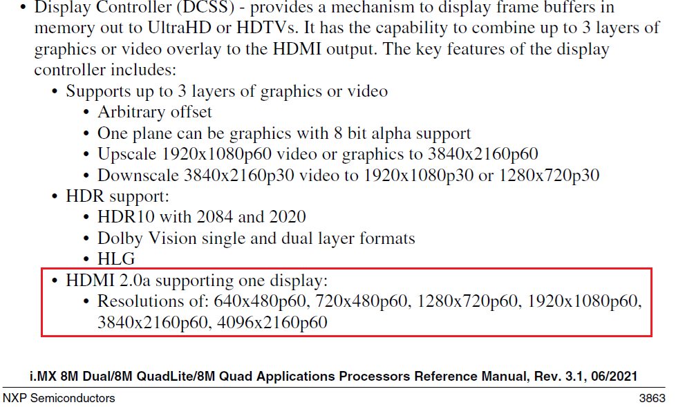

After checking HDMI SPEC, it supports 1920cx1080 as the picture below.
We try to configure HDMI 720x480 and 1280x720 video timing in DTS of uboot, and i.MX8MQ can detect right resolution then get into Android succesfully, please see the attachment, 480P_720P.zip, including 2 log files(720_480.log & 1280_720.log).
But we configure HDMI resolution as 1920x1080, why the system will find out 720*480 as the picture below?
Do you reproduce the issue on EVB of i.MX8MQ?
